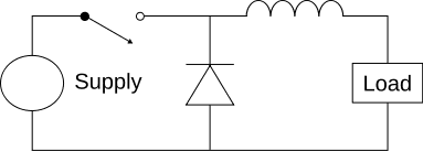

I've been looking around for formulas on how to calculate different aspects of DC motors and buck converters such as average current.
The reason is that I'm about to pick switch frequency for a motor, and don't know what characterics I can expect if I alter the switch frequency. Papers and publications regarding this are very much appreciated, as I haven't yet found any that answer my questions.
I succeded in coming up with a formula for the max current through a switched RL circuit with a freewheeling diode(essentially a DC motor with the emf substracted from the input voltage), related to PWM period and duty as
Imax = \frac{E}{R} (1-e-RDT/L/(1-e-RT/L)
Where R is the circuits resistance, L is the inductance, D is the duty ranging from 0-1 and T is period time.
The circuit would look like this, with the load replaced by a resistor:

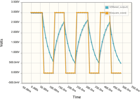

The output current would look like the non-square wave in this diagram:
I think its correct, at least the endpoints are as they should. If somebody is interested I'll can post the derivation for this one and a similar formula for Imin.

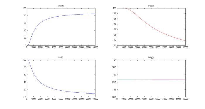

I tried to evalute
Iavg = 1/T∫i(t) dt
today, and came up with some rather clumpsy though exact expressions. As I couldn't simplify them enough to get an overview over the math, I used MATLAB to play around with it using the code below.
The result was surprising! No matter what switch frequency, the average current seemed to be constantly the same. Here is the resulting plot from the code below:
Why doesn't physicsforum have their own image upload btw?
If my expressions below are correct, all that is needed is some playing around with the algebra and the result would be a simple expression for Iavg involving just D, R and L I think.
It would also be interesting to see the transisition times between steady state, related to switch frequency.

The output plot is this:
Buck ckt - is Voltage Converter
IN the basic analysis Vout = Vin * Duty Cycle -- A buck ckt is a Voltage converter, and this is independent of Fsw.
Fsw is typically chosen for other factors: Losses and size of passives ( Magnetics and Caps), Ripple ( V and I) to the load, EMI, Audible noise, interference with other devices, etc...
The price for the higher Fsw is the switch and diode losses are increased. -- See the attached basic simulation - sorry I don't work with 1.5 V ! --- The good info here are the optional Characteristic plots at the end of the report. This is for sizing the power electronics - so the "limits" shown are based on maximum device temperatures - NOT the current changing based on the Fsw. For example at 20kHz the device can only handle 2/3 of the current that it can at 10kHz without overheating. - For a given load the current would be same as Fsw changes, but at 10kHz the dsvice can handle more load.
