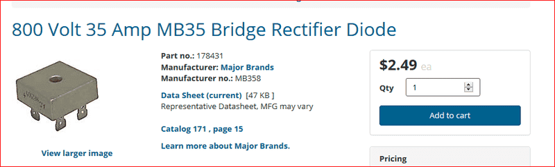

I once tried running a treadmill motor with just a bridge rectifier and ordinary lamp dimmer to see if it'd work, and it did, but the parts i used were underrated for connecting it to any sort of load. You'd need a 2000 watt lamp dimmer that costs one or two hundred bucks, probably more than something already made for the hobby market specifically to do what you want.
We could build one from scratch but you want a running lathe not an electronics research project.
That's my honest advice, not a dismissal.
