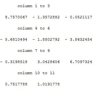

I'm trying to solve a non linear 11x11 system. (for eliminate harmonics in a power inversor)
I used Excel's Solver but it didn't work. (Solver couldn't solve the system). Then I found fsolve (a scilab function) but again it didn't work
I will attach the code used.

When i change the initial value in the script i got different solutions, when i substitute I found out that solution is actually false.

a0 = [0.1,0.1,0.1,0.1,0.1,0.1,0.1,0.1,0.1,0.1,0.1];
[ar, v, info] = fsolve(a0, system);
disp(ar)
disp(info)

Are you familiar with the papers on this topic that have been published by the IEEE? If so, which papers do you have? I may be able to steer you to some others.
No, my professor gave me only the Fourier coefficients formulas, with these formulas i obtained those equations from the previous post. I solved a previous exercise with Excel (there were only 3 equations, instead of 11).
Thanks in advance.
Varied considerations, I just couldn't resist...
Here you've chosen a single-ended inverter, sadly for you. An H bridge would give you three voltages +V, 0, -V with more flexibility, like the 1/3 2/3 waveform that suppresses harmonics 3 9 15 21. A three-phase output would do the same for free. Needs fewer transitions per period. A multi-phase inverter, like those feeding a Cpu, does essentially the same to reduce the ripple with one transition per period on each output.
Solving the equation for c=cos(a) would make it a set of polynomial equations, which I believe to remember is solved by Mathcad or Maple. That is, cos(3a) comprises cos(a) and cos3(a) and so on for higher powers, which you find through cos(a)=[exp(j*a)+exp(-j*a)]/2. Reinjecting the lower-power equations in the higher ones would then simplify them, possibly to contain only the highest power.
You can perfectly write a dumb software that tries all possible angles. a1 to a11 are between 0° and 90° and are in strict increasing order, so if you try all even degree angles between 2° and 88° you have 3411/11! combinations or 2 billions. Precompute 11 tables of 44 angles for cos(n*a), avoid repeated computations in nested loops, and a single Cpu takes 50 cycles per trial or 30s at 3GHz, without SSE nor multicore. Take the RMS power as a fast figure of merit.
Then, refine your solution within the (2°)11 hypervolume.
More subtle, you could keep a few near-best solutions that aren't local to an other, in case the best one is technologically bad, say if the transitions are too close to an other. Or if the 2° sampling let's you miss the true best solution.
