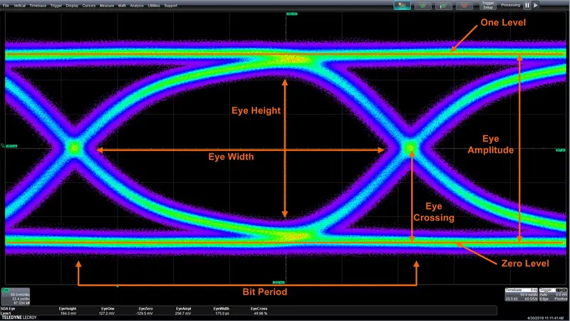

Also, you might look into digital communication systems. Even though this text is sent, received, and is quintessentially digital. It was sent to you on analog cables/fibers/radios. It might be the simplest example of the digital-analog interface problem. How fast can you move a bit in an analog world?
