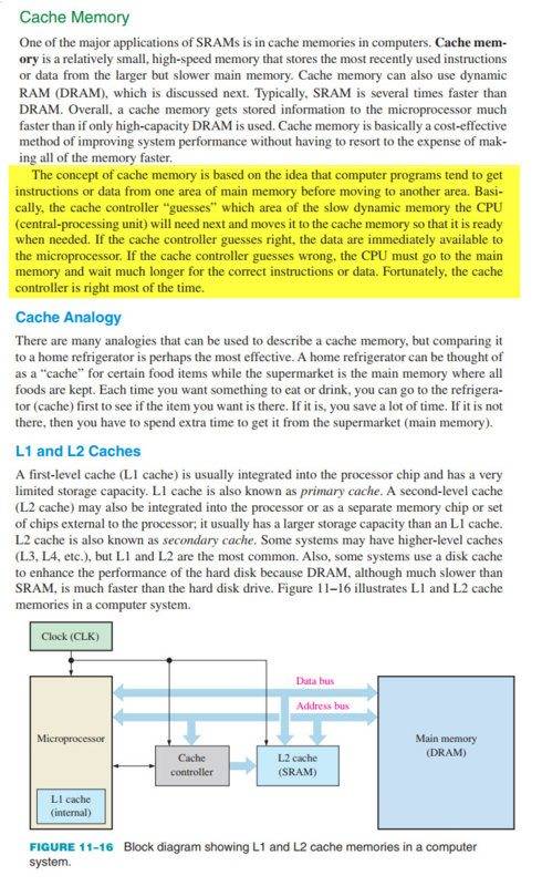

Hi,
I have always thought that BIOS program, which is firmware, of any computing device serves as an initiating set of instructions which launches the main program such as Windows.
Please have a look on this attachment. The following text is from the attachment.
"The concept of cache memory is based on the idea that computer programs tend to get instructions or data from one area of main memory before moving to another area. Basically, the cache controller “guesses” which area of the slow dynamic memory the CPU (central-processing unit) will need next and moves it to the cache memory so that it is ready when needed. If the cache controller guesses right, the data are immediately available to the microprocessor. If the cache controller guesses wrong, the CPU must go to the main memory and wait much longer for the correct instructions or data. Fortunately, the cache controller is right most of the time."
When I read the text above first time, I got the impression as if a cache controller also has a separate 'guiding' firmware, i.e. an algorithm, which helps it how to 'guess'. Now I think that I was wrong. A cache controller has an added ability to access several required locations of memory at a faster rate. Like it has 10 hands compared to two hands and each hand could reach to a different memory location at a very fast rate.
To get a better understanding I was trying to see how a GPU works. I have boldfaced the sentence which, I think, is the gist.
"A graphics processing unit (GPU) is a specialized electronic circuit designed to rapidly manipulate and alter memory to accelerate the creation of images in a frame buffer intended for output to a display device. GPUs are used in embedded systems, mobile phones, personal computers, workstations, and game consoles. Modern GPUs are very efficient at manipulating computer graphics and image processing. Their highly parallel structure makes them more efficient than general-purpose central processing units (CPUs) for algorithms that process large blocks of data in parallel. In a personal computer, a GPU can be present on a video card or embedded on the motherboard. In certain CPUs, they are embedded on the CPU die.[1]" [5]
Here, the architecture of a GPU helps algorithms to process data efficiently compared to a general purpose CPU. I believe that Artificial Intelligence Accelerator also facilitates artificial intelligence algorithms to process data more efficiently.
I'm still little confused about the working of a cache controller like how it guesses. Could you please help me with this? Also in the block diagram FIGURE 11-16 there is a double sided arrow between cache controller and microprocessor, what does it mean? That microprocessor and cache controller interacts with each other but in what way and how?

The cache controllers (in the CPU) are working with wired logic, there is no real firmware there.
That text from the attachment is a bit misguiding. The real concept is based on the statistics that usually a localized area of the memory is used more than once as the program runs. Like in case of a program loop: the memory occupied by the instructions of the loop will be re-read every time the loop turns. Something similar goes with the data too: usually there are small, frequently used data areas (but when it is about a sequential read of a GB long data field then no cache will help - not much, anyway).
If those frequently used areas are moved to a fast memory (access delay is 5-15 CPU cycle instead of 100+ cycle like for the main memory) then the program will run faster.
The actual algorithm will depend on the CPU type. The process is called 'prefetch'. The 'guess' part is actually not really big - if you want to see a difficult guess based on logic then you should check out the branch prediction instead.

Okay. So there is no firmware involved and it's all wired logic. The wired logic is also used in case of a look-ahead carry adder (that's the closest example I can think of).
In the block diagram FIGURE 11-16 there is a double sided arrow between cache controller and microprocessor. I believe it means that cache controller and microprocessors also interact directly with each other. It's really difficult to comprehend the guessing job of cache controller for a person like me. I don't think that a cache controller can just grab the current address from address bus and fetch all data surrounding or related that address expecting that the microprocessor is going to need a certain chunk of data. Or, the microprocessor might guide the cache controller itself because it could communicate directly with it to fetch the most expected data. But the only problem is that a microprocessor itself is a bare set of transistors and whatever without any intelligence of itself. It's the operating system which endow it with intelligence, right? I understand that at the very bottom level, an operation system, OS, also gets translated into an assembly language instructions which are a kind of 'hardware' commands to activate certain transistors etc. So, it might be possible that when a certain program is written, including OS, it is written in such a way to help a microprocessor to coordinate with a cache controller to speed up the action.

A very simple example of the cache process:
  • Cache Controller is monitoring CPU memory read requests
  • CPU accesses memory for an instruction
  • Cache Controller checks to see if that address content is in the Cache
  • If "No"
    • Read that memory location
    • return that content to CPU
    • Read content of next 16 memory locations into Cache
  • If "Yes"
Note that the Cache Controller and CPU can operate concurrently without interferring with each other. This means the Cache Controller can read the next memory locations above while the CPU is processing the data it was just given.
Hope this helps.

I'll just try to make few changes to see if I understand it correctly though I understand it's like splitting hairs.
  • CPU accesses memory for an instruction/Data
Tom.G said:
  • If "No"
  • If "Yes"
Would CPU wait on the cache controller to fetch it the required instruction/data from memory? Wouldn't it fetch it itself? But, yes, the cache controller would read the next 16 memory locations into the cache which CPU might find handy for next read cycles.
Originally it was a parallel process: the cache got the data off the bus the same time as the CPU (in case of a cache miss). Later on the cache became the part of the CPU, and by now the execution part of the CPU can't even 'see' directly the memory anymore: everything is done by the relevant subsection of the CPU which manages the cache and the memory too.
But it does...
For the PC world it started here, with the 82385 which provided cache control for early 80386 CPUs. Check on page 8, the section about 'Read misses': it does nothing else but fetching the full line which caused a cache miss and hopes that it'll do. And it did, a 386 with cache was quite a beast compared to one without cache...
And here is what it became. Read page 82, section 2.5.4.2. It is about some Intel 'Core' family CPUs. Some algorithms, but still not much what you would call real 'guessing'... So just don't overthink it.
