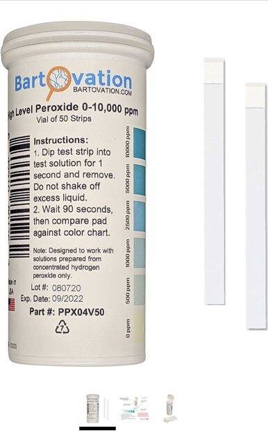

As far as a hydrogen peroxide test, there are test strips available to test for hydrogen peroxide concentration in varying levels. Here’s one for example…
Your 1:16 dilution from a 4.25% concentrate would give you about 2.7 g H2O2 per liter of dilution or 2700 ppm. Thats right in the middle of these test strips scale!
Good luck and thank you for your good work with the animals!

Those test strips look like a great idea. Of course they also have an expiration date. :-)
