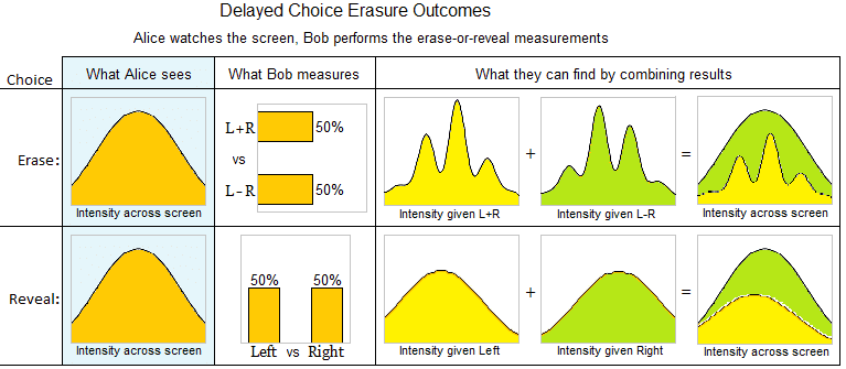

PBS SpaceTime did the "Why can't you win the lottery with delayed choice?" as one of their viewer challenges.
You can see the video containing the solution here (jump to the 4 minute mark):
And you can see the challenge video here:
The basic reason it doesn't work is that you don't ever see an interference pattern. You use the "erasure" measurement results to group the original measurements, which were just an indistinct blur, into two groups. The two groups will have interference patterns, and they sum to the lack-of-interferece that you saw, but you need the later measurement results to do the grouping.
Table comparing Erase and Reveal outcomes: Alice sees a single broad intensity curve in both rows, Bob's L+R versus L-R and Left versus Right each show 50%, and the combined results show interference peaks for Erase and two separate peaks for Reveal.
