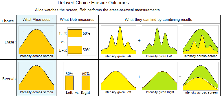

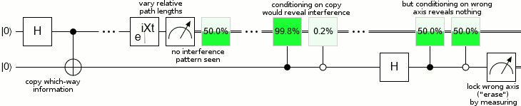

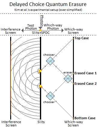

These are the diagrams I made to try to make it simple to understand.
The setup:
And the result (well, not exactly, since the above setup uses beam splitters instead of some kind of manual input for the choice and the labels for cases differ, but whatever):
And an equivalent quantum circuit that works on qubits, which is more abstract but avoids a lot of the vagueries of optics:
The setup:
----------- diagram deleted
