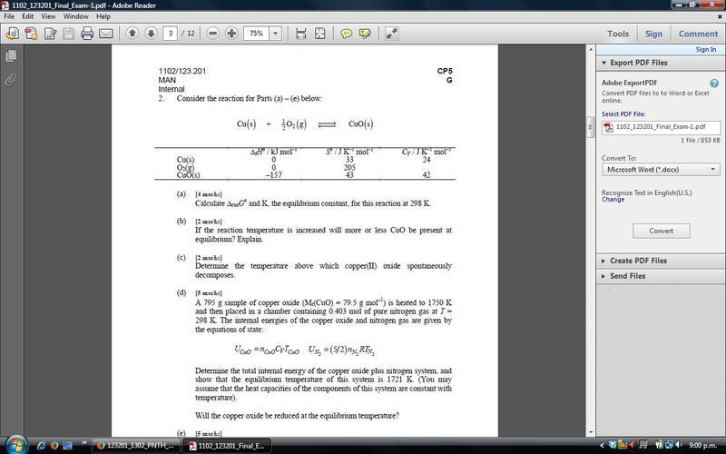

The equation and data to which the question refers is in the attachment. I am just trying to do part (a) of the question at the moment:
Calculate ΔG and K, the equilibrium constant, for this reaction at 298 K.
I would have thought that I would need to use the equation ΔG=-RTln K, but I am unsure how to find K, the equilibrium constant, because I am not given the amounts of the reactants or products.
Perhaps there is a way to solve the problem using an equation I am not aware of? And I am not sure how to use the data given to solve the problem, if in fact it is needed for question (a) I have no idea.

How is the standard free energy of formation of a species related to its standard enthalpy of formation, standard entropy of formation, and standard temperature 298? If you know the free energy of formation of each reactant and each product, how do you calculate the standard free energy change for the reaction?
If you can't answer these two questions, you need to go back to your textbook and find out.

I believe that I use the equation:
\Delta _{f}G^{o}=\Delta _{r}H^{o} - T\Delta _{r}S^{o}
and take the reactant values from the product? ie:
\Delta _{r}G^{o}=\Delta _{f}G^{o}(CuO)-(\Delta _{f}G^{o}(Cu)+\frac{1}{2}\Delta _{f}G^{o}(\frac{1}{2}O_{2}))

You have the right idea. Just one thing: lose the Δ's in your first equation, and, on the right hand side of your second equation.
