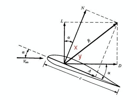

Good day all:
I'm having trouble deriving the forces for Lift and Drag in the attached diagram.
The text I have (Fundamentals of Aerodynamics - John Anderson) states the solution to be:
L = N cosα - A sinα
D = N sinα + A cosα
Can anyone guide me through this? I think the cofunction identity is used somewhere:
sin(90 - x) = cos x
cos(90 - x) = sin x
But that's as far as I've gotten.
Help is appreciated, thanks!

For ##L##:
##\cos (\alpha + x)=\frac{L}{R}##
So ##L=R\cos(\alpha + x)=R\cos x \cos \alpha -R\sin x \sin \alpha \ \ \ \ (1)##
Now ##\cos x=\frac{N}{R}## and ##\sin x=\frac{A}{R}\ \ \ \ (2)##.
Then (1) becomes: ##L=N \cos \alpha -A\sin \alpha##.
Similarly for ##D##:
##D=R \cos y= R \cos(\frac{\pi}{2}-\alpha -x)=R\sin(\alpha + x)=R\cos x \sin \alpha + R\sin x \cos \alpha##.
Using (2) again, you get ##D=N\sin \alpha + A\cos \alpha##.
