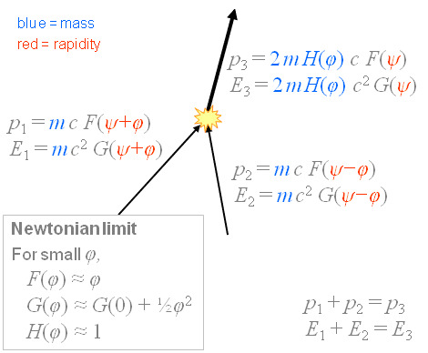

Most of the texts I've seen (admittedly not a large number) which introduce the concept of relativistic momentum usually just pull a formula out of nowhere and then prove the formula must be correct. There is nothing technically wrong with this approach, but it's aesthetically unsatisfying, as it doesn't show how you would get the formula if you didn't already know the answer. The few occasions where I've seen a derivation that didn't assume an answer (e.g. in Einstein's own papers) contain some rather ugly and tedious mathematics.
I thought I'd have a go at a more elegant method, and after some weeks of effort in my spare time, here it is. I wouldn't be at all surprised if someone else hasn't published something similar to this before, so I claim no originality.
I do assume a fair amount of background knowledge. You will need to know about rapidity and how to add it. You need familiarity with hyperbolic functions and their derivatives, partial differentiation and the solution of second-order differential equations.
I am confident of the logic that leads from my assumptions to my conclusions. The reason I am posting this is to ask whether the assumptions that I make are reasonable in this context. Could I simplify my argument still further with even better assumptions?

The specific scenario
Consider two particles of equal mass which collide and coalesce to form a single particle, with no loss of energy to the surroundings.
(A8) Measured in the rest frame of the final particle, the two initial particles have equal but opposite velocities.​
On grounds of symmetry.
Note also that as mass is invariant, the mass of the final particle depends only on the two initial particles and their relative velocity and is independent of the motion of any observer.

So, considering our two colliding particles of mass m as described above, moving with rapidities [itex]\phi[/itex] and [itex]-\phi[/itex] relative to the final rest frame, let the mass of the final particle be
(F7)...[tex]M = 2 m H(\phi)[/tex]​
for some smooth function H to be determined. In the Newtonian limit, mass is conserved so
(F8)...[tex]H(0) = 1[/tex]​
Note also that
(F9)...[tex]H(\phi) > 0[/tex]​
We have, relative to the final rest frame, conservation of momentum and energy
(F10)...[tex]m c F(\phi) + m c F(-\phi) = 2 m c H(\phi) F(0)[/tex]
(F11)...[tex]m c^2 G(\phi) + m c^2 G(-\phi) = 2 m c^2 H(\phi) G(0)[/tex]​
Note that either of the above equations implies that H is an even function, and so, in particular,
(F12)...[tex]H'(0) = 0[/tex]​
More generally, relative to a frame in which the final particle has rapidity [itex]\psi[/itex], we have
(F13)...[tex]m c F(\psi + \phi) + m c F(\psi - \phi) = 2 m c H(\phi) F(\psi)[/tex]
(F14)...[tex]m c^2 G(\psi + \phi) + m c^2 G(\psi - \phi) = 2 m c^2 H(\phi) G(\psi)[/tex]​
making use of the additivity of rapidities.
To summarise, both F and G are solutions for f of the equation
(F15)...[tex]f(\psi + \phi) + f(\psi - \phi) = 2 H(\phi) f(\psi)[/tex]​
each satisfying the appropriate boundary conditions as above.

Reminder
My main question is, are assumptions (A1) to (A8) above sensible?
