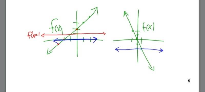

Handwritten graphs of f(x) on two axes: left, a line with positive slope crossing a horizontal blue arrow axis, with a red f(x)=1 line; right, a steep line with negative slope through the origin with a blue horizontal arrow.

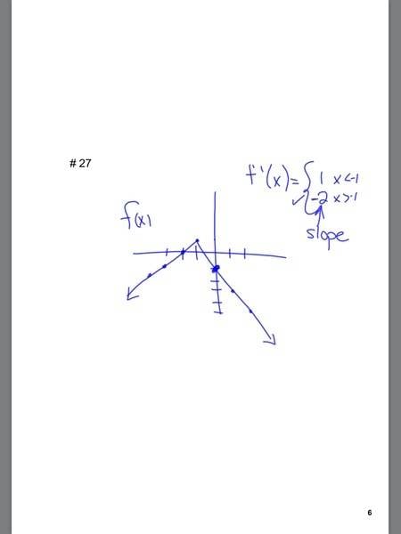

Handwritten sketch of a piecewise graph labeled f(x), with a corner near x = -1 where the line rises to the left and falls to the right, beside the piecewise derivative f'(x) = 1 for x < -1 and -2 for x > -1, marked slope.
This is my teachers answer. I understand how the slope is 1 for x greater than -1 and that it is -2 at x greater than -1 and that there is a point at (0,-1) but I don't understand how they connect to form that final pic. I think I'm missing something ,can someone help me?

What does it mean for a function to be continuous ?
That there are no breaks or holes
If f'(x)= 1, for x< -1, then f(x)= x+ C1 for some constant C1, for x< -1, so the graph is a straight line with slope 1.
If f'(x)= -2, for x> -1, then f(x)= -2x+ C2 for some constant C2, for x> -1, so the graph is a straight line with slope -2.
Since f is continuous, the two lines must meet at x= -1. That means that -1+ C1= -2(-1)+ C2.
That, together with f(0)= C2= -1 is sufficient to determine both C2 and C1.
