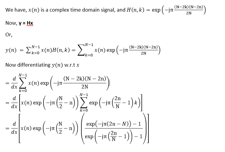

Dear Friends
So, i have this special case where i have to do a differentiation and summation.
Please check the following.
Is it okay ?? Or, i how should i proceed with this ?
ok, what you did in the bracket were algebraic operations and the use of the formula for geometric series ##\sum_{k=0}^{N-1}t^{k}=\frac{t^{N}-1}{t-1}## where ##k=e^{-j\pi(2n/N-1)}##, now you must derive the expression respect ##\chi## ...
