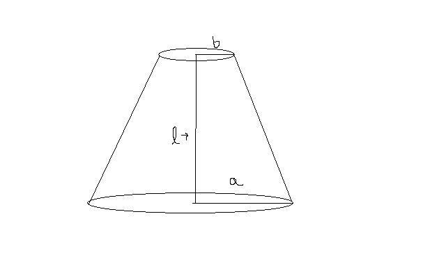

Suppose there is a Conical section (of a right circular cone) of total height 'l' and radii 'a' and 'b' (a>b). How do we derive the formula for the radius at a height 'h' (h<l) ?
Draw a cross section through the middle and look for similar triangles whose properties you can use to solve your problem. (I think you are describing a frustrated cone, not a pure cone?)
I am talking about this (see attached file).
  • Diagram of a frustum of a cone with top radius b, bottom radius a, and vertical height l drawn as a dashed line from the top center to the bottom.

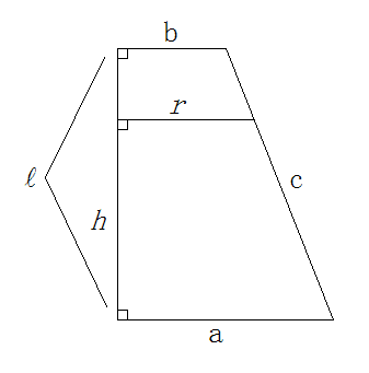

Forget the 3 dimensional aspect; it would be easier to think of a trapezoid with one side of length [itex]l[/tex], perpendicular to sides a & b. Call the remaining side c.<br /> <br /> a & b still represent the upper and lower radii of your truncated cone, and r represents the radius of that object at height <i>h</i> above side a.[/itex]
  • Trapezoid with labelled sides: top b, bottom a, slanted right side c, left side l, a horizontal segment r inside, and vertical height h, with right-angle marks.

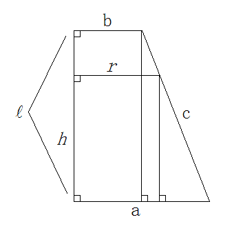

I find the algebra easier if you construct the additional 2 line segments shown in the attached drawing.
  • Geometry diagram of a truncated cone shown as a trapezoid cross-section, with labelled top base b, bottom base a, slant side c, slant length l, height h, horizontal radius segment r, and right-angle marks at the corners.
