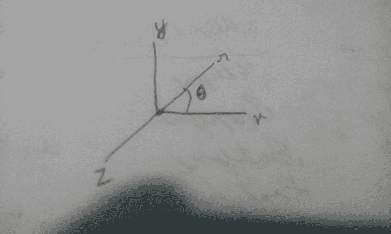

What I could draw that is It :
I think it wasn't correct graph. 🤔 (cylindrical was little bit harder that's why I am not taking a look at that.)

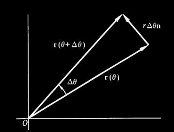

Ow! I got a figure in book.

Then, they wrote that $$\mathrm dr=\hat r \mathrm dr + r \hat \theta \mathrm d \theta + \hat k \mathrm dz$$
This is the differential increment in the position vector: How a small change in ##\vec r## relates to small changes in ##r, \theta, z##.
Note that it should be ##d\vec r## on the left hand side.

Yes the differential position vector comes from the derivative (with respect to time) of the position vector.
The position vector in cylindrical coordinates is $$\vec{r}=r(t)\hat r(t)+z(t)\hat z$$.
Take the derivative of that with respect to time and have in mind that ##\hat r(t)=\cos\theta(t)\hat x+\sin\theta(t)\hat y##. Also have in mind that ##r'(t)dt=dr,\theta'(t)dt=d\theta,z'(t)dt=dz## and that the unit vector ##\hat \theta(t)=-\sin\theta(t)\hat x+\cos\theta(t)\hat y##.
