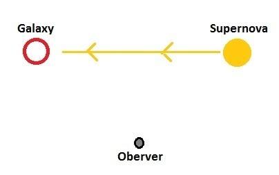

  • #41
PeterDonis said:
How is the observer going to make that measurement?
Like this for example :
In which the curvature of where the supernova and the galaxy lie is of a different factor than the curvature of where the observer is. I'd expect that because of the difference in curvature, and because of the expansion of the spacetime fabric the observer would measure a different speed of light because it gets influenced by the expansion and curvature in a non-peculiar motion way?
Also, is my first statement in my post #39 correct?
  • #42
That doesn't tell me how the observer makes the measurement.
You aren't thinking about how the observer is going to actually make the measurement. Think carefully, and remember that I said the locally measured speed of light is always c, and that the "speed" of a distant object relative to an observer is not well-defined in curved spacetime.
