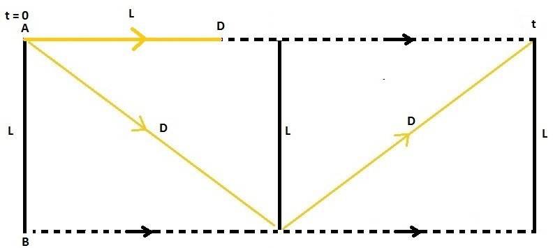

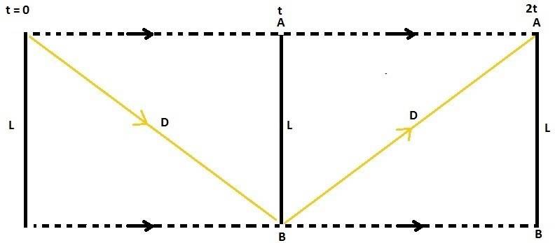

I've read about the light clock example but I'm having a bit of a trouble concluding it myself. Here's how I am reasoning and formulating it:
1. Suppose Observer A and B are standing face to face with a distance L between them and A shoots a photon to Observer B which he will receive in L / c time.
2.
In another scenario Observer A and B are both moving at the same velocity to the right and as soon as Observer A passes a standing Observer C, Observer A shoots a photon straight to Observer B. Observer C would see the photon move over trajectory D while Observer A would see it move over trajectory L. Observer C and A measure the speed of the photon.
Now, if the photon was a bullet from a gun that Observer A shot, Observer C would measure a faster speed of that bullet than Observer A. This difference in speed measures compensates the distance difference between D and L to make Observer B receive the bullet at the same time: t over D = t over L.
However, in case of a photon, the speed would be measured as c by both Observer C and A and yet, Observer B would still receive that photon at the same time even though D is larger than L. This means that the time the photon travels over D must be less (slower) than the time it travels over L.
In other words, if B would hold a clock pointing at 5 ‘o clock as soon as A shoots the photon, A would see B receive the photon at 5 ‘o clock + t’ according to B’s clock. Observer C would also have to see B receive the photon at 5 ‘o clock + t’ but since it takes longer for the photon to get to B from C’s perspective (trajectory D), that + t’ from C's perspective must be reached at a slower pace.
So, C measures the slower pace time t over trajectory D and A measures a time t’ at which B receives the photon. Since c is constant that means that L / t’ = D / t = c. Trajectory D can be written as √((vt’)2 + L2) so that:
This can be rewritten as :
Thus, t’ would equal:
From there, I can’t seem to rewrite it to get the standard Lorentz formula. What am I doing wrong here?
No, it means that the time the photon travels over D must be more (longer) than the time it travels over L. More distance, same speed, means more time.
This is actually already the key thing about the light clock: the photon going from A to B corresponds to "half a tick" of the light clock. To make a full "tick", you would just put a mirror at B and have the photon reflect back to A--that would remove some implicit assumptions about simultaneity. For A, the full "tick" takes time 2L / c. For C, the full "tick" takes time 2D / c, which is longer because D > L.
But now: put a second mirror, E, opposite C, i.e., it is at rest relative to C, not A, and at distance L from C, relative to C. Have C emit a light pulse towards the mirror at E at the same instant that A passes him--i.e., at the same instant that A emits a light pulse towards B. Have both pulses reflect and return to their sources. Which will arrive first, according to C? Obviously the pulse that went from C to E and back to C, because it only has to travel a distance L each way; so it will take time 2L / c according to C to return, whereas the pulse emitted by A, that reflects at B and goes back to A, will, as above, take time 2D / c, which is longer.
In other words: one "tick" of A's clock corresponds to more than one "tick" of C's clock. That means A's clock is running slow, relative to C's clock.
I think you're mislabeling the times. See my comment above about the round-trip time A-B-A being longer (not shorter) in C's frame.
Ah, I think I got it now. I got these times confused and it seems that I was still calculating the time of an event outside the observer (L / c instead of 2L / c)
So, for Observer C he would think that A would receive the photon after (2D) / c time. While Observer A would think he would receive the photon after (2L) / c time.
The trajectory 2D would, for Observer C, be defined as √((vA x tc)2 + (2L)2) so that the time duration according to him would be √((vA x tc)2 + (2L)2) / c = tc.
I noticed that Wiki is showing the same formula but rewriting it in such way that it turns into the Lorentz formula (still have to find out how exactly though)
One question though: in this case Observer C is calculating the time at which A would receive the photon back again (2D / c) but doesn't this mean Observer C is assigning a time to an event that is spacially separated from him as well and thus relativity of simultaneity would mix here as well?
Yes.
Yes, good catch. :wink: It's impossible to avoid that complication completely in deriving time dilation. But this scenario has the minimum amount possible of the complication, so to speak: there is only one event (the event where A receives the light pulse that was reflected from B) that has to be assigned a coordinate time using a simultaneity convention, and only by one observer (C, the one who sees A's light clock as moving).

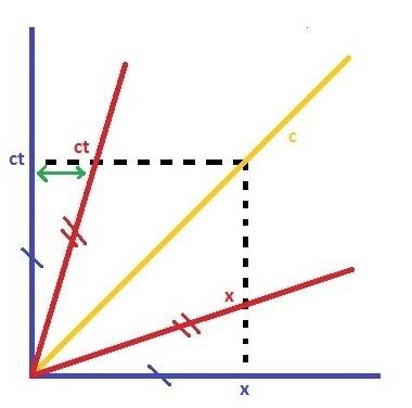

I’ve been trying to derive the time dilation using the Minkowski Diagram drawn colorfully by me here:
Let’s say that the blue reference frame is Observer A and the red one is Observer B.
I concluded that the width of the green line can be calculated with the following formula:
The blue ct means (t/c) seconds which is the time duration for Observer A (t / c = tA). Thus, vB x (t/c) = x which is the distance that Observer B makes in tA time. Here, tA is the time according to the blue (Observer A) line and vB is the velocity of Observer B with respect to Observer A.
I would think that therefore, the length of the red ct (the timeline of Observer B = ctB) can then be calculated using Pythagoras:
√((vBtA)2 + (ctA)2)= ctB
To prevent very small numbers, let’s assume that vB = 3, c = 50 and ctA= 1
Using this formula gives me ctB = 1,001798 and thus tB = 1,001798 when tA= 1
When I use the same values of vB = 3, c = 50 and tA = 1 in the Lorentz formula, I get a very similar result: 1,001804
My question is, why is there still yet such a small difference between the answers? This might sound a bit too farfetched, but is this difference the influence of relativity of simultaneity?
EDIT: I've noticed that rewriting my above concluded formule gives me: tB / √((v2/c2) + 1) = tA. So obviously, for small velocities this would give me similar answers as the Lorentz formula which is tB / √(1 - (v2/c2)) = tA. But I have no idea why my formula has a √((v2/c2) + 1) in the denominator while it should be a √(1 - (v2/c2)) like the Lorentz formula.
No, it can't. The point you have labeled as "the red ct", i.e., the point where the black dotted line from the blue "ct" point to the green line intersects the red "ct" line, is not the point that labels the "time" it takes the light ray to travel in the red frame. To obtain the correct point, you need to draw a line from the black "corner" (the point where the two black dotted lines meet at the green line, which is the point the light travels to) to the red "ct" line that is parallel to the red "x" line--i.e., this line will slope down and to the left, as the red "x" line does, so it will meet the red "ct" line at a point below where the dotted black line crosses it. Similarly, the proper "red x" point is not where the vertical black dotted line crosses the red "x" line; you need to draw a line from the black corner that is parallel to the red "ct" line, and find where it meets the red "x" line, which will be somewhere to the left of where the black dotted line crosses the red "x" line. (Note that the reason the black dotted lines work for finding the correct blue points is that they are parallel to the blue axes.)
Another way of looking at it is that the Lorentz transformation turns a square (formed by the blue axes and the black dotted lines) into a rhombus (formed by the red axes and the lines I described above). To get the correct numbers, you need to figure out the side length of the rhombus.

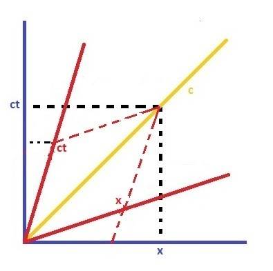

Thanks, so it should look like this?
I was able to conclude that this is indeed a rhombus by reasoning that the angles that are opposite of each other are equal so that the red "ct" line, the red "x" line as well as the the dotted red lines that intersect them should all be equally long. However, I can't for the life of me conclude what the length of each side of the rhombus would be unless I use cosinus with angles. Should I do that or is there a way without??
EDIT: Hold on, I think I'm about to get this.. will reply in a sec.
EDIT2: Nvm, I still can't solve this without using cosinus
Yes, you've got it.

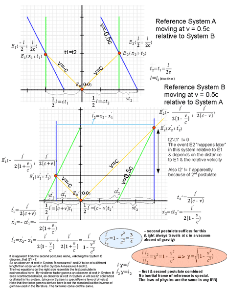

I tried the same as you basically. To derive the formulas of SR following the two postulates only and this is what i came up with.
I cleaned it up a bit but there might be some errors still.
The gamma i get is the inverse of the standard gamma, but that is only because of the way i derive it. It just makes sense this way. The formulas are however the same as the standard ones when doing the calculations.
It's basically your example, except in this case, you have observer in system A switching on some light at Eo, and the resulting light beams in yellow going in both directions. Two objects, depicted as the green and blue worldlines of the objects in the x/t diagrams.
In System B you see the same light beams emerging from a point Eo'. Since they also have to be measured at c, the speed of light, by observers at rest in System B, l2' and l' cannot be of the same length anymore. The rest follows from the formulas which if developed further can give you the lorentz transformations, time-dilation, length contraction etc.
edit: If you are wondering how i got the lines right in System B here is the explanation.
Surely an observer at rest in System B traveling at vrel 0.5c relative to System A would see the flash of light as well. That is Eo'. When he does, the green object which is at rest in System A would be seen by him traveling at vrel 0.5c, which is why the green lines are diagonal now.
We also know that Eo' would be in the middle of the green object in System B just like in System A. (One could make the case that this has to be proven but it would be far fetched)
The light beams going out from Eo' will meet the green object edges at some point, which will be our E1' and E2' events.
We know that the blue object edges (worldlines) will meet with the light beams and the green object worldlines at E1 and E2 in System A. So logically they will also meet with E1' and E2' in system B, except that in system B the blue object is at rest and therefore the worldlines go straight up.
From there it's just maths and calculating the space and time intervals, except for the formulas you get by translating the first postulate into mathematical form, which is also the most difficult part to understand.
ignore above drawing. While you get the correct value for gamma, i made a mistake with green worldlines in System B. The green object in System B should have a negative velocity of 0.5c just like the blue object in system A. I realized it when i tried to develope the lorentz transformation formulas.
x'= gamma (x-vt) would give me the correct values only if i used 0.5c for v instead of -0.5c.
It makes sense that if an observer at rest in System A sees the blue object approaching him and moving away thereafter, then an observer at rest in B should also see the objects at rest in System A move towards him and then away. Hence negative velocity if we were to use the same methodology in both Systems as in how to declare which side of the x-axis should be the positive and which the negative one.
The second diagram would have to be flipped around on the x-axis basically to be correct.
Those are quite some fine details which obviously escaped me when i drew the diagrams.

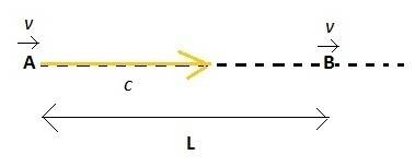

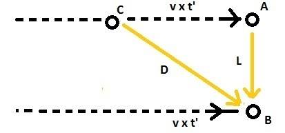

Please bear with me here. So here's the example once again:
Let's say that now, instead of C standing in the left upper corner (at the t = 0 sign), C is now looking at this whole picture while moving with a velocity v so that A and B are moving with velocity v in the opposite direction with respect to C. Remember how we derived the Lorentz formula by using an event in which A receives the light back again with respect to A himself: (2L) / c = tA, and with respect to C: (2 x √((vtc)2 + L2)) / c = tC? Here's the thing, I am able to conclude the Lorentz formule also by calculating in how much time, B would receive the light signal with respect to C and A instead of A receiving it:
For Observer C, he would calculate that B would receive the signal in √((vtc)2 + L2) / c time. A would calculate that B will receive the light signal in L / c time. So for C: √((vtc)2 + L2) / tC = c and for A: L / tA = c.
**First, let's derive "L / tC" from C's perspective, we concluded that for C: √((vtc)2 + L2) = ctC so that v2tc2 + L2 = c2t2 and thus we can divide all parameters by tC2 so that we get v2 + (L2 / tC2) = c2 which means that √(c2 - v2) = L / tC.**
If A were to use the time duration of C (tC) in his formula L / tC, he would get an answer that is smaller than c (<c) since tC is longer to cover distance D with a velocity c. This means that the factor by which c would get smaller if A uses tC's time duration in L / tC, is the same factor by which A's time tA gets smaller with respect to tC to make L / t = c according to A.
So, <c / c = tA / tC. If we write <c as its formula L / tC, we would get (L / tC) / c = tA / tC. The (L / tC) in the formula can be rewritten as the formule concluded above (see **) so that √(c2 - v2) / c = tA / tC.
Thus tA / (√(c2 - v2) / c) = tC. Now, this looks a bit different from the original Lorentz formula (I can't seem to rewrite it) but it seems that it gives the exact same values for any v value as the Lorentz formula.
Here's what I find weird. I was now able to derive the Lorentz formula from an event (B receiving the light signal) that is spacially separated from both C and A who are assigning a time to that event. If I can do this, then I should be able to derive the formula from my first example in my opening post as well, since in that example there are also 2 observers assigning a time duration of an event that are spacially separated from them. Here's the example of my opening post:
Suppose Observer C is looking at this event as he passes A and B by with a velocity v and thus seeing A and B are both passing with a same velocity v in the opposite direction. A and B are separated by a length L and A shoots a laser towards B. Observer C would think here that the time the light signal would get to B would be the distance L plus the distance that B would make with his velocity v in L / c time, thus ((vL / c) + L) / c = tC. A however, would think that B would receive it in L / c = tAtime. Combining these 2 formulas would give: tA ⋅ ((v + c) / c) = tC which is a formula that is way off the Lorentz formula.
Now, why does this second scenario give me another formula regarding time dilation while I'm doing the same thing as in my light clock example? Both A and C are assigning a time to an event that are spacially separated from them in both scenarios and yet, I was able to derive the Lorentz formula from the light clock and not from the second example. This makes me think that the Lorentz formula can only be applied in a scenario in which the light signal is traveling diagonally with respect to one of the observers. Does this mean one has to use a different formula when seeing a light signal traveling in the same direction as the Observer who's shooting that light signal?
I don't understand. In the diagram, A and B are moving to the right. How is C supposed to be moving, with reference to the diagram? To make it concrete, suppose there is another observer D who stays at the upper left corner, where C was standing in the previous version; how is C moving relative to D?
Sorry for not being clear. What I meant is that C is standing still and looking at the scenario just like you're looking at the screen to see the diagram and he's seeing A and B moving to the right. The same goes for my second scenario.
I already covered this in my posts #6 and #8. I'm not sure what the issue is.
Your second scenario is the "parallel light clock", i.e., a light clock where the light ray bounces back and forth in a direction parallel to the clock's motion. This is another good exercise, but it adds an additional factor: length contraction. In the frame in which the clock is moving (i.e., C's frame), the distance between the light source and the mirror (i.e., A and B) is contracted. So it isn't a good scenario to use if you just want to understand time dilation.
