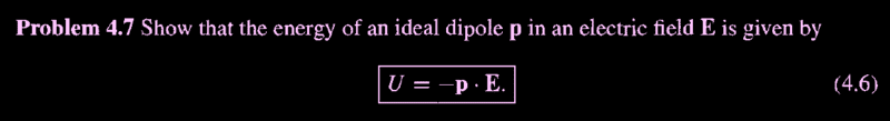

In case of uniform E, torque ##\vec N = \vec p \times \vec E
\\ U = \int_0 ^ \theta N d \theta = pE \int_0 ^ \theta \sin \theta d \theta = - pE \cos \theta
\text { Here, I assumed that the direction of } \vec N ~ and ~ \vec d \theta ~ are ~ same .
\\ U = - \vec p \dot \vec E ##
How to show the same for non - uniform E ?

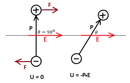

Is it the sign that you are worrying about? It can be tricky.
In the figure above, the positive direction for θ is counterclockwise from the electric field direction.
So, positive torque would be counterclockwise. You can see that the torque on the dipole is clockwise. So, the torque N is negative and should be written N = -pEsinθ. The work done for rotation by dθ is Ndθ = -pEsinθdθ.
dU is the negative of the work done. So, dU = -(-PEsinθ)dθ = +pEsinθdθ. So, your calcuation for Uf - Ui was correct!
I was not clear about the direction of ## \theta ##. Thanks for pointing it out.
Work done by the electric force is defined as W = ##\int_{\theta _i}^ {\theta _f} \vec N⋅ d \vec \theta ##
Now, ## \vec N = \vec p \times \vec E = pE \sin \theta ~ \left (- \hat n \right)##
## d\vec \theta = d \theta \left ( \hat n \right),~~~ d \theta = - |d \theta| ##
The clockwise direction of ##d\vec\theta ## is taken care of by the limits of the integration.
So, W = ##\int_{\theta _i}^ {\theta _f} -pE \sin \theta d \theta ##
U_f - U_i = - W = ##\int_{\theta _i}^ {\theta _f} pE \sin \theta d \theta = ## ##\int_{\theta _i}^ {\theta _f} N d \theta ##
So, ##\int_{\theta _i}^ {\theta _f} N d \theta ## is the work done against the electrostatic torque, not work done due to the electrostatic torque.
