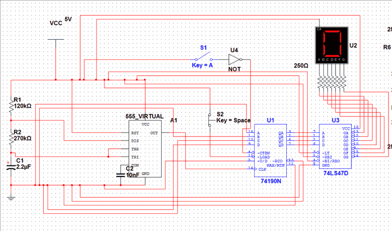

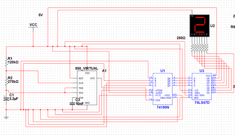

I think I will use a 555 timer because I'm a bit more familiar with it. I tried a basic decade counter to start with using multisim. But when I start the simulation, the display shows this:
2,3,8,9,0,1,2,3,4,5,6,7,8,9
Why does it start from 2 and jump like that, then continue as normal ?, here's my circuit diagram:

you need to add a reset line for it to work on the first go around

you have three inputs to your system...
stop
start,
and resetlook at your memory storing device (the counter) and determine what pin will cause the states to go to zero (or their initial states)?

ok.
a few things. you have outputs tied to ground, which can be a BIG no no.
also you should not enable cten until you are ready to start, i recommend starting cten at logic hi, then moving it to logic low and seeing what happens. further looking at the chip, everything is reset to their initial values (which are a,b,c,d) when cten goes low.

When you look at the datasheet for the 74190 part, what does the LOAD input do?

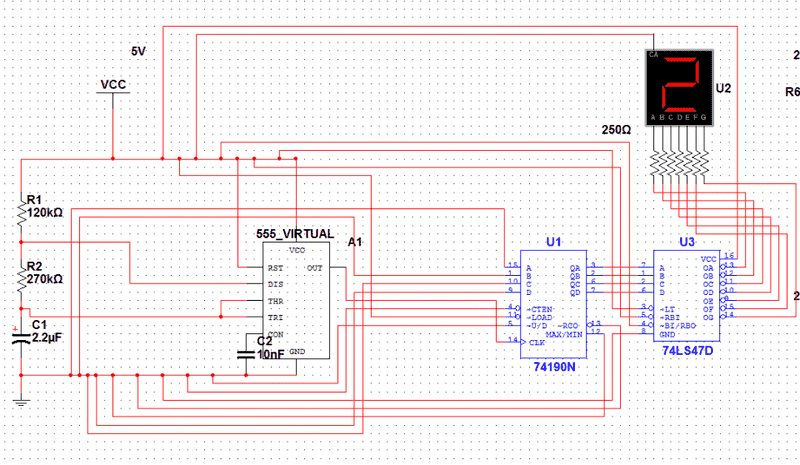

Okay, according to the responses I modified the circuit to this
@donpacino, When I start the simulation with the switch open and then close it the counter counts as normal which seems to fix the problem. Also I tied those outputs to ground because I am not using it, where must I tie them to if I am not using it ?
@berkeman, The load input loads the value connected to A,B,C,D so to reset to zero, I used a push button
Unused outputs are left no-connected (or in a production design, they are connected only to test points for manufacturing test use).
Unused inputs must be tied off, usually just to ground (or to ground through a resistor, to allow for manufacturing test via a test point on the input). :smile:

If a output is driven high, and you tie it low, you are shorting the voltage supply to ground, with only a transistor or two in between. that could damage your chip or power supply
ok great! now how do you implement the reset/start/stop buttons?
you might be there already with some of them!

I tested the reset button S2 connected from LOAD to 5V and it works. Also for switch S1 when I open the switch while it's counting it stops the count, I'm not sure whether it would work in practice. Also do I have to debounce the switches ?

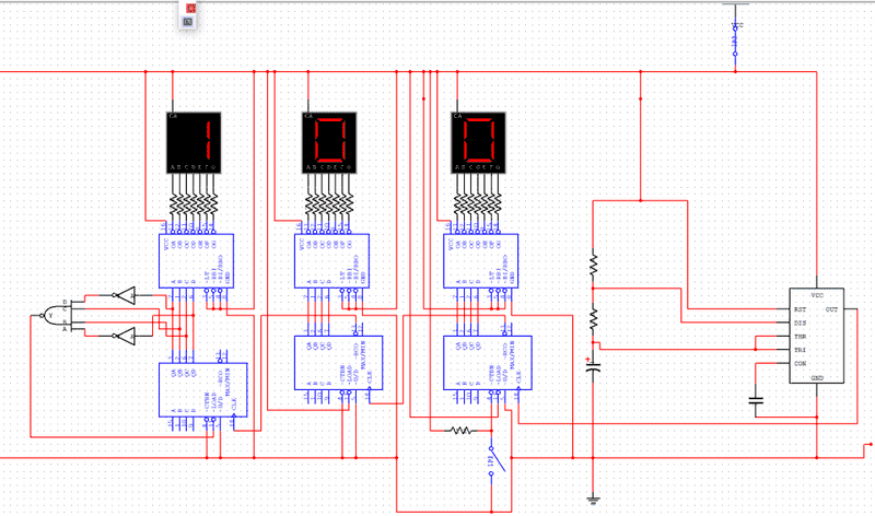

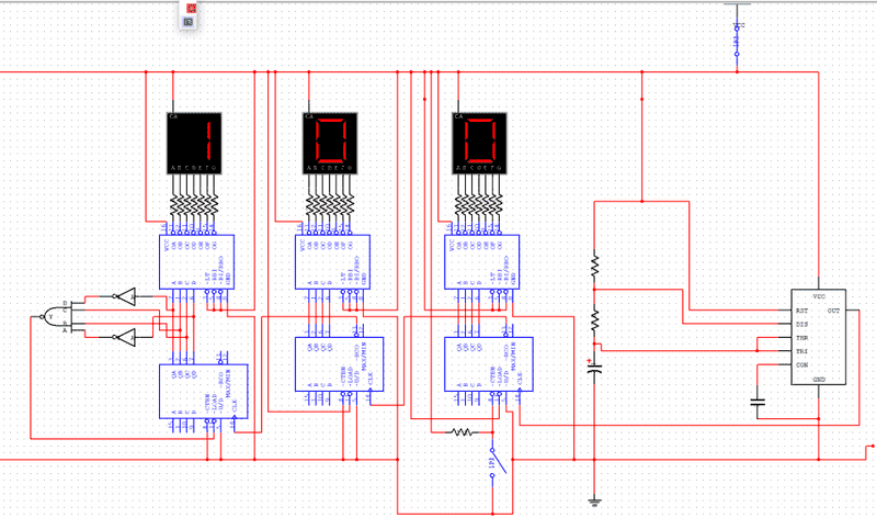

Why does the last counter start at one ?
why did you get rid of the switch for your load sequence?
like i said you NEED to load values at the beginning.

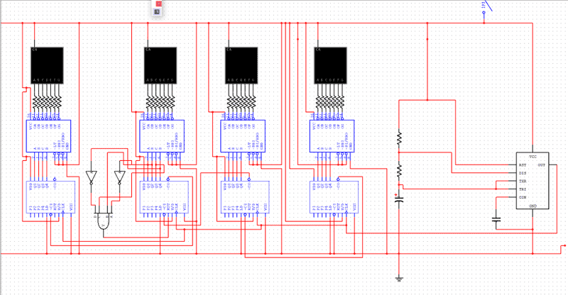

I changed the counter to a 4510. I added a logic reset to the third counter from right to reset when it reaches 6 which works fine. But now I need the last counter to increment in order to count the minutes. The way I have it connected now, the last display doesn't do anything, it just stays at zero
so you have that logic reset triggering the load input, you need that logic to trigger the next stage as well.
