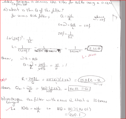

Design a series RLC filter for 10kHz using an 0.01mF capacitor.
/ 3. The Attempt at a Solution
how would the circuit actually look if drawn out here?
[/B]

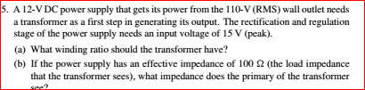

There are two different questions in this post. Please make two separate threads.
Well, it's two parts of the same question I was just curious with the information I have how a circuit diagram would actually look.
e.g. is there a specific way the resistor, capacitor, and inductor must be oriented? Like, if it's RLC must they be designed Resistor first, then Inductor, then Capacitor?
The thread title doesn't match the problem statement. Presumably the question is about designing an LRC filter and not about a power transformer?
Oh sorry! I must have written the title regarding the next problem. Yes, it is about designing an LRC filter!
I'll change the thread title.
Is your capacitor specified in microfarads (μF) or millifarads (mF)? It can't be made out in the image of your work. It would be better if you could type out your work. It makes it easier for helpers to interpret, quote, and comment on.
