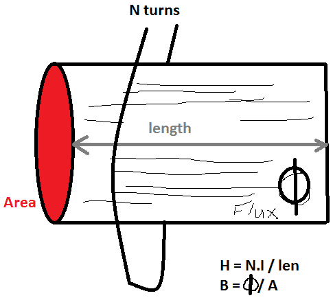

Oh dear I am confused now. I thought I'd better do a picture just so there can be no 'crossed wires' :P
I'd never even heard of some of those cgs units. Thanks. Yep, I was talking AC.
You've pointed out that when I "locked amps I locked flux density B" which I didn't realize, so how can you move back down the curve to move the operating point to the knee from saturation by adding more steel? Surely I don't need to lower the current...I'm just thinking about huge transformers etc.
My second question is, is it ok to think of H as externally applied, fixed length, fixed turns number, fixed 'H'?
Thanks
well, you could add length to your iron path instead of cross sectional area. Or you can add a small air gap.
BUT - i notice your sketch shows a bar not a closed loop core. If your core is just a rod not a toroid or something, then your magnetic path is half air. Inside the coil flux travels in iron where u is hundred if not thousands, but outside your coil it's traveling in air where u is just 1.. So nearly all your MMF is expended in the air. Flux in a long solenoid will only about double when you insert the core. So, if your sketch represents your apparatus, saturation won't be a problem.
Calculate how many amp turns it takes to push 1.5 Tesla through similar lengths of air and iron.

I'm not physically building anying just yet, though good point about concidering a closed and nonclosed path. I am going to be doing some work on toroids though but good to know the sketch would be half air core (retun path).
Ok, so you're saying length is the only parameter I have to work with (physically changing a design), if there is no air-gap?
Otherwise I need to lower the current (or voltage), as B is foremost depenant on current, rather than area. (Ie. B = u.N.I/l locks 'B' so Bmax = V/N.A.w can't lower 'B' as the 'A' is increased)

tim9000 said:
If one wished to have a large inductance, wouldn't having an air-gap be detramental (forget about linearising the curve for a moment) because it would increase the reluctance path?
Indeed. That's why i so dislike that little Radio Shack transformer, the core is not held tightly together.
When you want a precise and predictable inductance in a closed core you include an air gap. Some adjustable inductors use a mechanically adjustable air gap.
Are you making a power transformer where you want low exciting current, or an inductor where you want constant reluctance? As you are experiencing, iron is nonlinear and a bit of air in the path will help straighten out the curve over some operating range..

tim9000 said:
One issue I'm having is that I can see all the equations, but I can't get a feel for what's happening.
There's the rub, eh ?
I have that trouble too. As i said in another post, the mind can believe anything so i have to constantly cross check my "feel" against the math, tuning my "feel" as i go so it leads me to the same formulas as the giants on whose shoulders we stand. My memory is awful so i have to figure out equations because i just can't remember them. But i think I'm getting along okay for the plodder i am.
My trouble came from trying to treat magnetic field the same way as circuits. In circuits we use simple Volts for E and Ohms for R and Amps I for current.

tim9000 said:
I'll assume that in adding steel, it only matters if it adds to the magnetic path length. But I'm still grappling with how is Area important then?
You are making an inductor. Inductance is FLUX X TURNS/AMPERES. You've locked turns and amperes, so what is left to determine flux?
Well, Flux is MMF/ℝ . By locking amps and turns you have only ℝ left to adjust. So you can adjust ℝ by area or length of magnetic path.
More area = less reluctance, more length = more inductance.

tim9000 said:
yet the Right hand side of that Faraday derivation also seems like it consists of variables you can directly infulence, as with the second equation. So what resolves the possible conflict?
Above did it for me but i may be on a different tack than you... can you expand on 'conflict' ?
tim9000 said:
if you had a bar inductor, and you wanted to think of a magnetic circuit, would you just take the total path as being length of iron reluctance + length of iron (but for the reluctance of air) i.e the air path is the same length as the iron?
That's what i do for an approximation and it works fairy well. It works really well for explaining why flux only doubles when you insert a core into a straight solenoid.

Perhaps my conflict is bet illustrated with a fake example:
u = 1.2 (some made up Amophorous metal, for numerical simplicity)
N = 100
A = 0.1 meters squared
Max V = 1000 V (60 Hz as you are accustom)
so Omega w = 2pi.60
I = 10 A
Mag Len l = 1m
B = u*N*I / len = 1.2*100*10 / 1 = 1200
max B = max V / (N.A.w) = 1000 / (100*0.1*2pi*60) = 0.265
So I'd have to lower the area heaps? Likewise, if I was to use the flux equation you outlined: Φ = V/N*w = 0.0265
but also Φ = u*N*I*A / len = 120
So which Flux do I go with? There must be some simple inconcistancy I'm making but not realising. So I must disagree, my maths is not superior to yours, in this instance least of all.
I think i see your dilemma...
You see that these two equations are the same
tim9000 said:
B = u*N*I / len = 1.2*100*10 / 1 = 1200 <---------> Φ = u*N*I*A / len = 120
because the second one is just the first one with both sides multiplied by A.
Here's the disconnect:
You specified an inductor with ten volts per turn which at 60hz means.
10 = * w* Φcos(wt) ::: that's just familiar old n dphi/dt
10/377 = Φcos wt
Φ = .0265, which in your 0.1 meter^2 core is the B you calculated. That's the total flux(not flux density) to make 10 volts per turn, or 1000 volts per 100 turns at 60 hz.
Now - what current will make that flux?
You said you'll have 10 amps through that inductor. Well not at Φ = .0265 you won't. At 10 amps you'll get the other flux that you calculated.
B = u*N*I / len = 1.2*100*10 / 1 = 1200 , 1200sin(wt) for 60hz AC
And your volts at that flux will be what ?
V = ndΦ/dt , which = 120pi * 1200cos(wt) = 452400 45240 volts/turn
which is an impossible result - so what happened?
Aha - u is relative permeability, and must be multiplied by μ0 which is 4pi X 10-7
and your value of 1.2 for u is almost air... a 100 turn air core inductor won't make much flux
so multiply by μ0
452400 X 4piX10^-7 = .57 0.057 volts per turn , way more reasonable.
had trouble editing jh
Try to go back to the concept i had cemented into my alleged brain with my transformer core experiment,
volts per turn at given frequency is a direct measure of flux Φ, not fluxdensity B.
Flux is ∑amp turns X area/length, X physical constants μ0 and u ,
Flux density B and MMF per unit length H are convenience terms that let you have equations not involving geometry so they work great for writing textbooks and printing datasheets.

You make a very valid point about the value of the current changing, however I was writing a defined case just for the example, as in I defined it that way. You also pointed out to me that I should have been more clear in my definition, I was giving the actual permiability, not the relative permiability like you interpretted, for like Metglas or some such core.
Oh Jim! That's dedication, I'm so sorry you spent an hour in Paint! I feel terrible.
I should have written that u was actual permiability, not relative, like for a Metglas.
So you were (wanting to) using the left Secondary as for doing the wealding and the right leg with the air gap to regulate the flux in it?
So I was right, there is a mutual exclusion in that:
'I need to define either voltage or current, otherwise I'm going to get an inconcistancy in flux'?
And to have so much flux through this (ur.uo = 1.2) such a big area (0.1 m^2) would require an impossible V/turn? InterestingI know that having losses in eddy currents cause heat, but the point you raise about having external heat reducing eddy currents will increase flux (and thus voltage, sounds good, maybe improve efficiency?) any problems with external heating within reason?
Thank again for all the detailed replies!
tim9000 said:
And to have so much flux through this (ur.uo = 1.2) such a big area (0.1 m^2) would require? produce? an impossible V/turn? Interesting
You're getting mighty close ! Probably you have it... just in case.. which is better verb to use? Require, or Produce ?
I'd state it thus:
(recall 120pi=377 , from slide rule days - saves one motion)
you used B = 1200
1200 Tesla over area 0.1m^2 = 120 Webers ,
and a single turn enclosing AC flux flux of 120sin(377t)Webers will have induced in it voltage(dflux/dt) of 377 X 120cos(377t) = 45,240 volts .
That's a LOT of volts per turn, and it takes a lot of current to push that much flux through air. That's such an improbable number it triggers a "Say What?" response.I used to carry around the plant a 0.1m^2 coil with ten turns hooked to a battery powered oscilloscope looking for stray fields. . A few feet away from the main generator conductors i could get around 3 volts as best i recall.
3volts in 10 turns is 0.3 volts per turn,
so 0.3 = 377 X Flux,
flux = 0.3/377 = 0.0008 Webers , in 0.1m^2
so B = 0.008 Tesla
That's in air, a few feet from a busbar carrying 20 kiloamps.
So when i saw B = 1200 Tesla in a core that's almost air, u only 1.2, i made same observation as Joni: something's impractical about our assumptions. Air should be in the milli or micro Teslas with only ten amps. Not to mention most steel saturates around 1.5 to 2 Tesla.
Your math was fine. Your thought experiment did the job. Thanks for the effort !

Ha, oh dear, what I mean is I had 'u' correct in the first place, it's not like an air core, I should have specified because the permiability is SO HIGH (1.2) I should have specified that it wasn't the relative permiability. I thought an Amophorous metal like metglas would work well in the example but it just caused confusion.
So if there was more flux due to the increased temperature, did that mean the permiability was increasing, and your inductance was going up? (nonlinearly)
Finally, so was I correct interpreting you that one can't set V and I and use these formulas:
B*A = V / N*w
or B = u.N.I / l
at the same time because they both produce different amounts of flux? Hense you must either choose current or voltage? Because what I think you're getting at is that I've been looking at those equations like how I just wrote, but the way I should think about them is:
B = u.N.I / l
Thus V = B*A*N*w (for the length of all the turns)
and not B= V / A*N*w
as I originally thought?
Good talking with you

Ahhh i see ... i did get confused... Steels i know of won't carry 1200 Teslas they'll saturate before 2T, so i assumed you'd made a mistake there. Sorry for doubting you.
B*A = V / N*w
or B = u.N.I / l
You GOT it ! Probably you had it from the start. I have to work from mental models and i envy people who can work straight from the equations.
When you pick volts per turn you've defined flux
so pick an area for core that'll support that flux without saturating,
B is flux/area
then pick amp-turns you want to produce that B and you've defined reluctance of your core, which is set by its u and length and airgaps, and if you have to reach back and tweak your area - well, so it goes !.@ dlgoff - Thanks for the kind words ! You are always supportive and it's appreciated..
B = u.N.I / l
Absolutely.

By length of turns (that was a stupid way of writing it) I just meant the voltge per whole lot rather than V/turn.
