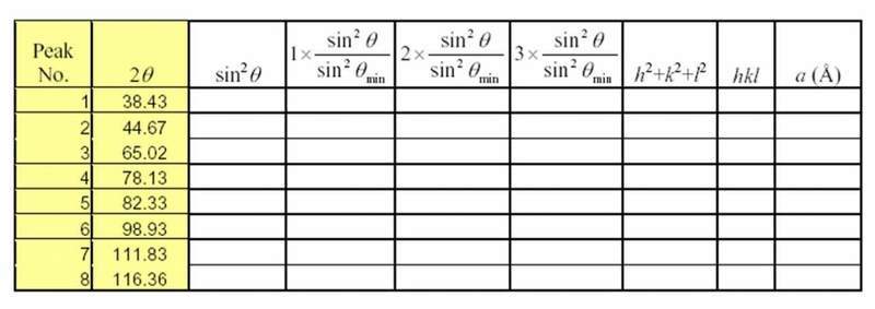

i want to know what is the formula for finding a,b,c using 'd' and 2theta values. also if the structure is known how to calculate miller indices for the corresponding peaks

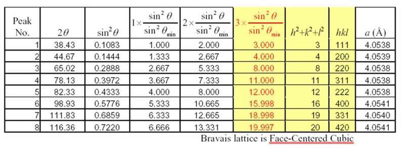

For Cubic crystal finding hkl (miller indices) is easy note that peak in xrd is a importent factor
(1) Identify the peaks.
(2) Determine sin2[itex]\theta[/itex]
(3) Calculate the ratio sin2[itex]\theta[/itex]/ sin2[itex]\theta[/itex]min and multiply by the appropriate integers.
(4) Select the result from (3) that yields h2 + k2 + l2 as an integer.
(5) Compare results with the sequences of h2 + k2 + l2 values to identify the Bravais lattice.
(6) Calculate lattice parameters.
Identify the peaks and their proper 2 values. Eight peaks for this pattern.

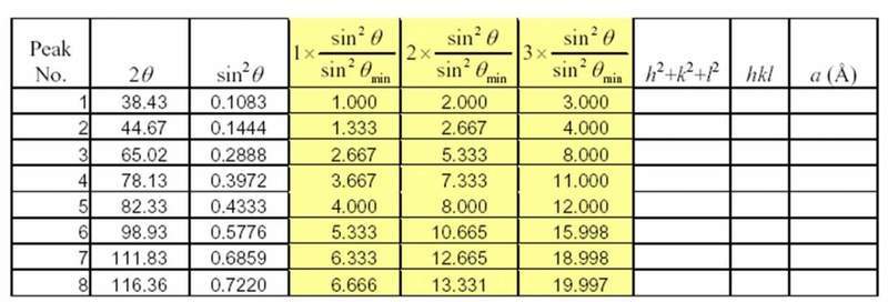

Determine sin2

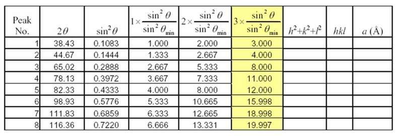

Calculate the ratio sin2/ sin2min and multiply by the appropriate integers.
Select the result from (3) that yields h2 + k2 + l2 as a series of integers.
