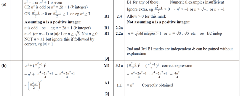

Participants note that the marking scheme indicates that only odd integers are valid solutions, but there is uncertainty about how to prove this condition. The discussion also highlights the need for clarity regarding the conditions under which the inequalities yield integer results.

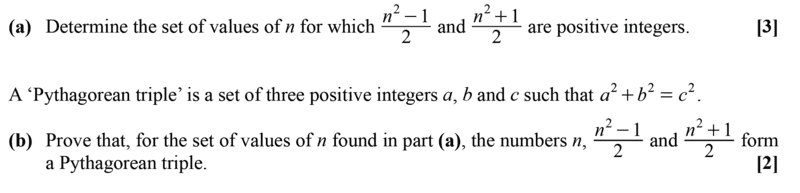

Ok i just want clarity for part (a),
My approach is as follows, since we want positive integer values that satisfy the problem then,
##\dfrac {n^2-1}{2}≥1## I had earlier thought of ##\dfrac {n^2-1}{2}≥0## but realized that ##0## is an integer yes but its not a positive integer.
Therefore,
##\dfrac {n^2-1}{2}≥1, n^2-1≥2, n^2≥3 ⇒n≥\sqrt 3##
For,
##\dfrac {n^2+1}{2}≥, n^2≥1⇒n≥1##. The inequality satisfying the two is
##n≥\sqrt 3##
...Any insight on this is appreciated.
Part (b) is easy...no problem there...
The typed up image has a lot of "or"s that probably are supposed to be "and"s. Is that an official grading rubric? I would give it half points at most.
It's kind of lame to not just name the smallest integer that you computed, which is 2, not ##\sqrt{3}##. But just to make sure, ##(2^2-1)/2=1.5## is not an integer, so there is more work to be done.
Yes, its an official ms guide from a past paper...

True, i had ##2## in my original working and thought i had done something wrong! Since ##n≥\sqrt 3⇒n≥2,nε\mathbb{z}^{+}##
Great. What about the part where not all choices of ##n\geq 2## satisfy this? You have the positive part down, what about the integer part?
Great. What about the part where not all choices of ##n\get 2## satisfy this? You have the positive part down, what about the integer part?
I hope i am getting you right, we have ##\sqrt 3=±1.73205...## We will not consider the negative values of ##n## as the question only requires us to find positive integer values of ##n## . In that case the value of ##n=-1## will not be a solution.
At this point, you have given the requirement for ##\dfrac {n^2-1}{2}## to be positive.
It should be very easy to show that ##\dfrac {n^2+1}{2} \gt \dfrac {n^2-1}{2}## for all ##n##, so the requirement on ##n## remains the same. I suggest using subtraction.
Seems like it's still left to show that to get integer results, we need that ##n## must be odd.
Yeah. I'm referring to the part where only odd n give actual integers. You haven't mentioned it at all in your posts.

chwala said:
True, i did not mention that...i guess the ms is clear on that part...
Yes, it is true that the ms (marking scheme - or whatever) is clear in stating that ##n## must be an odd integer. What's not so clear in the ms, is how to show that.
What's even less clear is your approach to showing that ##n## must be odd.
