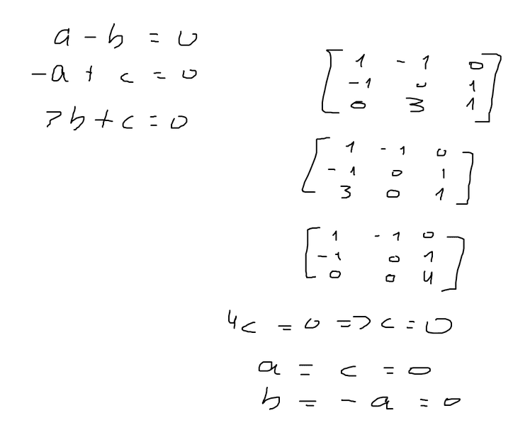

Ohhh yea, I went through the calculation and they are linearly independent in ##\mathbb{R}^3##.
So the answer is that the subspace generated by ##A## is ##P^2(x)##. Never the less I would like to know how would we write our answer to the problem if the subspace didn't cover all of ##P^2(x)##. Can someone tell me how to express the subspace in such case?
