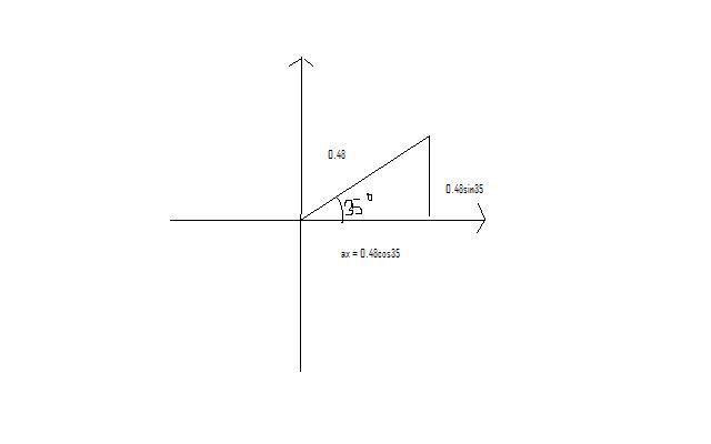

You're sailing at 6.5ms^-1 when a wind gust hits, lasting 6.3s accelerating your board at 0.48ms^-2 at 35° to your original direction.
Find the magnitude and direction of your displacement during the gust.
Attached is the magnitude of the displacement. How should I go about determining the direction of the sail board?

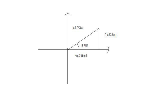

I ought to have been clearer in my question: I have determined the angle of displacement (6.394 degrees from the x-axis but I am unable to visualize a schematic as to what is going on)
could someone give me a leg-up?
You numeric results are correct. What sort of visualization do you have in mind?
You could take a piece of paper, and draw a rectangular system of axes on it. Let at the beginning of the gust the boat be at the origin. Plot the trajectory during the gust.
Where should the x and y component of the velocity go? what about the angle of displacement?
Do not plot the velocity. Plot the position. That will give a visualization of the trajectory.
Does this make sense?
I would normally expect axes too be oriented differently, but that is not essential. The initial and final points are indicate correctly. But the trajectory should not be a straight line.
Should it be curve due to the acceleration? If so, how should it be imposed- below the hypothenus and connecting the hypothenus?
You do not have to guess. Take a number of times between zero and 6.3 seconds and compute the position at those times. Then connect them on your diagram.

Here is another consideration for you. Let the y-axis be parallel to the direction of acceleration due to the gust, and x be perpendicular to it. What will the trajectory look like in these coordinates?

s = vt when there is no acceleration. Which is not the case in this problem. Besides, (48.749ms^-1i , 5.4633ms^-1j) is the final displacement, not the velocity.
What a blunder to have taken displacement x time.
If the acceleration is not constant, none of the kinematics equation can be used, isn't it?
Why is the acceleration not constant? As I said, you got the correct numeric result originally. What can't you repeat the same thing, but for different times?
Ok. I read your post wrongly. I read it as "no constant acceleration" instead of "no acceleration".
The solution is then;
ax = 0.393ms^-2
vx = 6.5ms^-1
ay = 0.2753ms^-2
vy = 0ms^-1
s = vit + 0.5at^2
s = (6.5ms^-1, 0ms^-1)([t=0,1.26,6.3]s + 0.5(0.393ms^-2,0.2753ms^-2)([t=0,1.26,6.3]^2
The above would give me the position of (i,j) from [t = 0,1.26,6.3] →from t=0 to 6.3 in segments of 1.26s
Yes, that seems OK.
But pay attention to #10 as well. You do not need to compute anything there. Just think.
