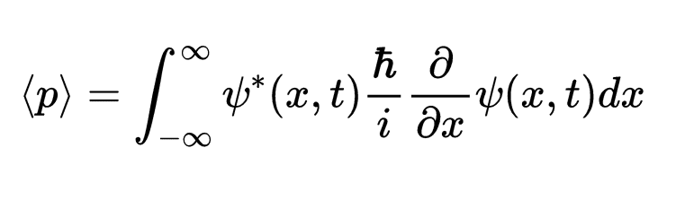

Can I not approximate this derivative to gain the expectaion value of momentum?
(sorry for the image, the latex didn't work)
It depends on the wavefunction. The alternative is to Fourier transform to momentum space.
Once you have a specific wavefunction then you use numerical methods.
