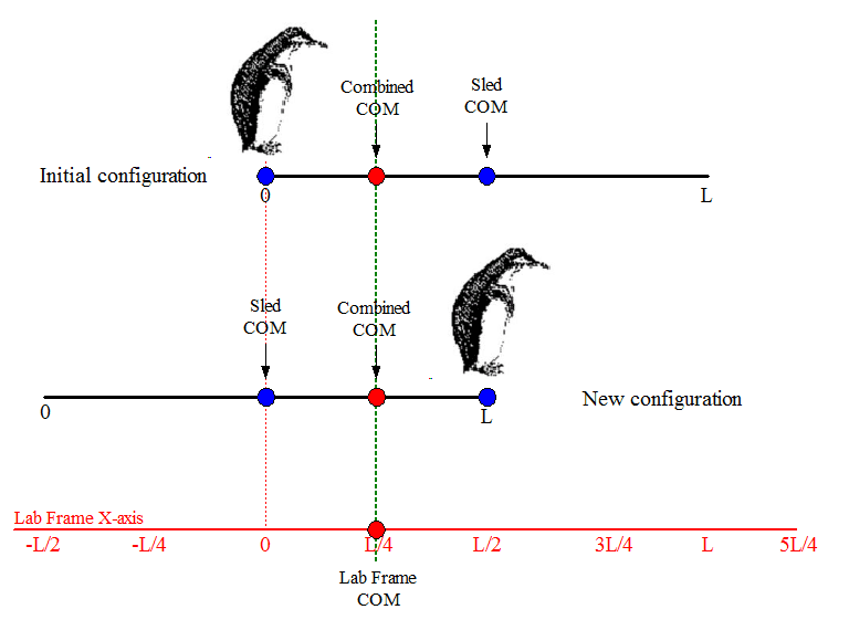

Since the COM of the whole system as viewed in the Lab frame doesn't move (right?), it can be convenient to use before and after sketches of each situation, label the resulting COM in the sled frame, then align that sled COM with the Lab frame's original COM. Then make your measurements/calculations from the resulting image.
For example, for part (2) the penguin moves from one end of the sled to the other:
https://www.physicsforums.com/attachments/91080
That is incredibly helpful, thanks a lot! I was confused how much the sled actually moves back in the lab frame but that pictures makes it crystal clear.
