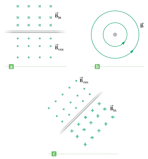

In each of parts (a), (b), and (c) of the figure below, find the direction of the current in the wire that would produce a magnetic field directed as shown.
part (a) right to left
part (b) out of the page
part (c) lower left to upper right
Ughhhhh
So, the right hand rule, predictably doesn't work for this...
Part A for instance, the top half of the diagram...since the magnetic field is coming OUT of the page towards you (or the magnetic field/flux out of the page is INCREASING, a current will generate a magnetic field in such a way that it goes INTO the page...this cancels any changes in the magnetic flux - Lenz's law.
So I do the right hand rule with my right hand and find out that for the TOP half of the diagram, the current is CLOCKWISE (goes from LEFT to RIGHT)
http://hyperphysics.phy-astr.gsu.edu/%E2%80%8Chbase/magnetic/imgmag/magcur.gif
THEN I tried doing the bottom half, which was the opposite...
The current was COUNTERCLOCKWISE (goes from RIGHT to LEFT)
-___-
So how is the answer, overall, Right to left?
In situations like Diagram A and Diagram C do I ONLY look at the half that has the dots (and not the X's)??
riseofphoenix said:
Ughhhhh
No, the right hand rule works like a charm. :smile:
The top half shows the magnetic field going into the page. It's even labeled Bin!
This problem is just the magnetic field created by a current. It does not involve induced currents, changing flux, or Lenz's law.
Just grab the wire with your right hand. Which way must your thumb point so that the fingers curl in the direction of the field?

OHHHHH...
Right to left!
I think my problem was that I confused the X's and the dots.
Because I always though X's meant the arrow/magnetic field line is coming TO YOU OUT of the page and the dots meant that the arrow/magnetic field line is going INTO the page AWAY from you...
So ESSENTIALLY, if the diagram is labeled with Bin if there are X's, then that tells me the magnetic field lines are going INTO the page, and if it says Bout, when there are dots, the magnetic field lines are coming OUT of the page...
But what if they don't tell me this on a test?
If there are just X's, do I THEN assume that it's Bout (and not Bin), or do the X's ALWAYS mean Bin?
riseofphoenix said:
OHHHHH...
Right to left!
When in doubt, you can always ask.
But the use of dots and Xs is pretty standard. Here's what it means:
Imagine the field as a arrow. The dot represents the tip of the arrow, so where you see dots the field points out of the page. The X is supposed to represent the tail of the arrow (feathers, I guess), so where you see Xs the field points into the page.
Make sense?

HINT: For the crosses and dots, think of an arrow - as in archery.
If the arrow is going away from you, you see the "feather" end - the crosses.
If an arrow is coming towards you, you see the point end - the dot.

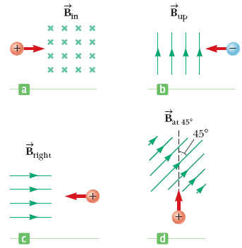

Wait one more quick question though...

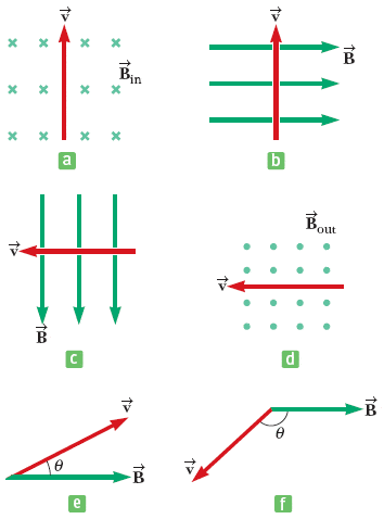

So, if X's represent the arrow going IN, why is the direction of the force on a proton (a positively charged particle) moving through the magnetic fields in Diagram A to the left??
2. Find the direction of the force on a proton (a positively charged particle) moving through the magnetic fields in the figure, as shown.
This time youre supposed to use Fleming's Right hand rule
http://www.ustudy.in/imagebrowser/view/image/3476/_original
Does the THUMB represent velocity V and the middle finger represent direction of force on a proton? Because like the diagram I posted here on top, the other diagrams on other websites say that the current and voltage is the middle finger and the thumb is the direction of force on a proton/electron. And that's what I followed to answer these questions... but got A wrong... Because what I did was, since they said voltage/current is the middle finger, magnetic field is the index finger, and direction of force on a proton is thumb, I got that the direction of force on the proton (for part A) was to the RIGHT and not the left :(

If you insist on using that version of the right hand rule, then the first finger represents current (or direction of motion of the positive charge), the second finger represents the field, and the thumb represents the the force on the moving charge.
What but, based on what the answer is ("to the left"),
the index finger is magnetic field
the thumb is velocity
and the middle finger is direction of motion on a positive charge.
So is that a different kind of Fleming's Right Hand rule?

That "dynamo Rule" shows you the direction of the current in a dynamo or just a wire, when it is forced to move [perpendicularly to its length] in the direction of the thumb, in a field in the direction of the first finger. the current will be induced in the direction of the middle finger.
The reason it seems backwards / counter-intuitive is that a dynamo in a circuit takes the place of a battery.
Everyone learns that current flows from the positive terminal of a battery to the negative terminal. But that is out side the battery - in the circuit. Look at what happens inside the battery.
That is the reason many people get the wrong answer when trying to predict which end of a wire moving in a magnetic field will be positive. Inside a battery current flows to the positive terminal.

Read what I wrote. What I wrote is for finding the direction of the force on a moving charge in a magnetic field: \vec{F} = q\vec{v}\times\vec{B}
So I'm guessing THIS is for finding
Direction of force on a moving positive/negative charge (quick question: for the negative charged particle, do I use the LEFT hand or do I still use the right hand?)
If it was a negative charge, I would still use the right hand rule but know that the answer will be opposite to the thumb direction.

Those two descriptions both look backwards to me.
If you want to hold your right hand like that:
Index finger = direction of field
Thumb = direction positive charge is moving
Middle finger = direction of the deflecting force.
If the moving positive charges are a stream of protons, that is the direction the stream will be defected.
If the "moving positive charges" represents conventional current - then the middle finger gives the diection of the deflecting force on the wire. The physical set up will determine if the wire will actually move that way - it may not be physically possible for that to happen.
As for negative charges: You work out which way positive charges would go, and the negative ones go in the opposite direction.
