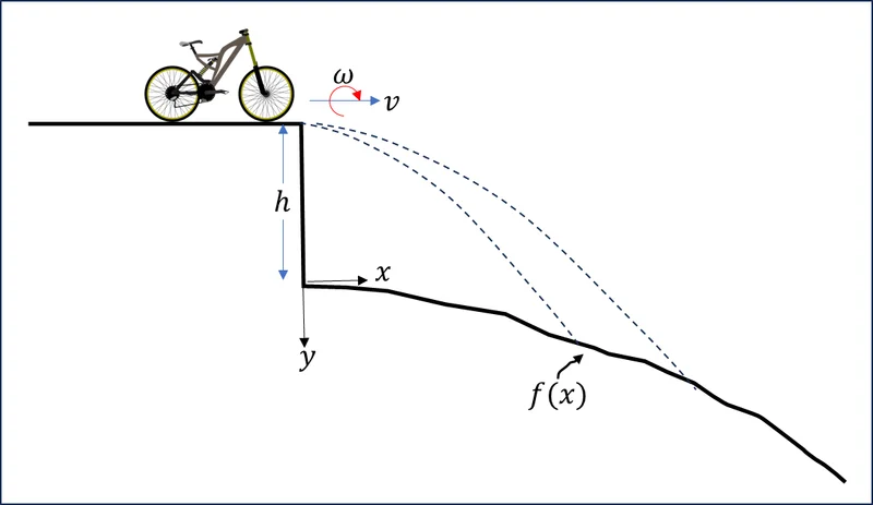

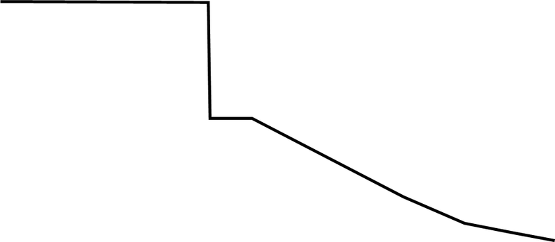

I do downhill Mt Biking - and this question popped into my head; Is there a kind of "optimal" landing profile mathematically for a drop feature that is not obvious in the sense that it is not what we "intuitively design" for landings on these features?
Diagram of a bike leaving a drop edge with velocity v and angular velocity omega, showing dashed projectile paths landing on a sloped ramp profile f(x), with height h and x-y axes marked.
My idea is that the bike leaves the top of the drop with a certain velocity ##v##, and angular velocity ##\omega## that are related through Newtons Laws and the bike geometry. Ignoring drag, these parameters remain constant throughout the remaining projectile motion(s).
I "feel" as though I would like the landing profile ##f(x)## slope at any point of landing (at particular set of initial conditions on ##v## and ##\omega##) to coincide with the angle through which the bike will rotate until that point is achieved.
This is not what is done in practice. The idea in the field is that the feature builder would want you to get the speed "right enough" to land somewhere around "here", and put some slope on it (estimated from past experience) in that region and let the shocks do the rest... hopefully well enough.

This mathematical problem seems challenging to me, I don't know if I'm really rusty, or if I've ever solved one quite like it. I'm expecting some differential equation to describe it.
Any thoughts/opinions appreciated.
Also, for the sake of simplification ignore the bike geometry w.r.t. the landing profile, I certainly don't want to get that in depth.
Is the sole criterion that the bike lands with both wheels simultaneously? I would assume that in practical terms you also want to limit the impact speed.
An analytic solution would be difficult, but there is a numerical solution. Start with the highest possible take-off velocity and compute the points along the curve, working back towards the take-off point at lowest velocity.
You know the rate of bike rotation about the centre of mass, due to the front wheel departing the edge before the rear, and you know where the front wheel will hit the flat ground beyond, so you can work out where the rear wheel will be at that same instant. Join those two points with a straight line approximation.
Lower the simulated speed very slightly, and work out where the front wheel will hit the previous velocity's straight line. Mark that point, and where the back wheel will be, then construct another line through the two points. Repeat that process until the line segments reach the point of the take-off. Then you have a line of dots that define the curve of the landing ramp.
You can refine the curve by adjusting the position of the body centre of mass between the wheels, and by raising the rear wheel contact point, so bikes land on the rear wheel just before the front wheel, if that attitude is what you want.
Also, simplify the initial curve generation by computing the wheel axle positions, ignoring the wheel diameter(s).
You might feather the curve into the track ahead, for the highest possible computed velocities. Also consider a vertically-uncurved track, for the ramp just before take-off, as that will stabilise the entry into the flight during the initial computations.
I would thing that the optimal landing slope profile would create the same delta-V on impact - regardless of the exact horizontal velocity. The actual bike pitch moment can be controlled by the biker at the moment the bike crosses over the top of the cliff.

@erobz Another numerical solution approach:
- Define a vector field, by assigning each point in space the orientation of the bike during a jump from a given launch point.
- Use a streamline algorithm on that vector field, to compute the landing ramp profile that is always parallel to the local bike orientation vector.

Instead of defining the initial ramp drop h, you could also assume some maximally possible initial speed v, and specify how far down you want the bike to drop for that extreme case. It's just another way to constrain the problem, that might be more useful in terms of ensuring safety limits.
erobz said:
My idea is that the bike leaves the top of the drop with a certain velocity v, and angular velocity ω that are related through Newtons Laws and the bike geometry.
What is a reasonable way to express the relationship between v and ω based on the bike geometry? I guess that it's an inverse relationship (the smaller v, the greater ω), but that there is a maximal ω for very small v.
Taking the wheelbase as 2L, mass centre at midpoint, and assuming it can only rotate through a small angle before the rear wheel becomes airborne, I get the final ω as ##\frac{2g}v\frac{mL^2}{I+mL^2}##.
If v is small then the angle change becomes significant.
##\omega^2\leq \frac{2mgL}{I+mL^2}##

I'm getting ## \omega = \frac{L^2 mg}{(mL^2 + I)v } ## otherwise ( the factor of ##2## )we align on the approximation.
Never mind. I see we have more time for the applied torque than I accounted for. You are correct.
