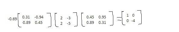

939
110
I am pretty sure I went completely wrong but not sure where. Please help!
2 -3
2 -5
2 -3
2 -5
(note: I apologize for poor notation)
eigenvalues = -4, 1
eigenvectors = (1/√5)(1/2), (1/√10)(3/1)
The matrix is not symmetric, thus the diagonal is (Q^-1)(A)(Q) = λ
What you have done looks good but your last line is not at all clear. You have not said what "Q" is. [itex]Q^{-1}AQ[/itex] is a 2 by 2 matrix, not a "diagonal", and you have not said what "[itex]\lambda[/itex]" is intended to mean. Your attachment is correct.
