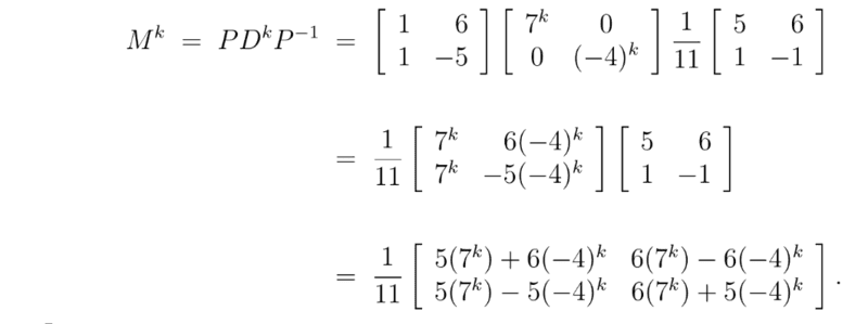

For this,
Dose someone please know where they get P and D from?
Also for ##M^k##, why did they only raise the the 2nd matrix to the power of k?
Many thanks!
Just add, that they are raising the whole thing to power ##k##, but you didn't notice that many things cancel.
##M^k=(PDP^{-1})^k=PDP^{-1}PDP^{-1}\dots PDP^{-1}=PDD\dots DP^{-1}=PD^kP^{-1}##
