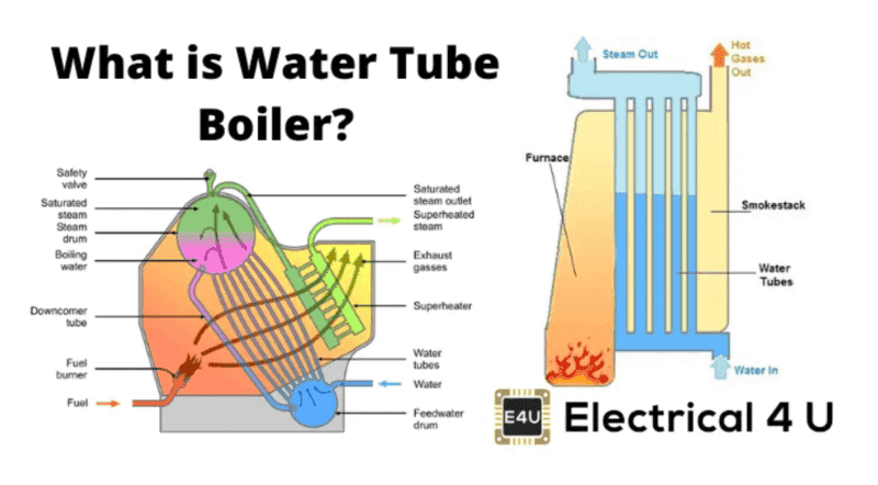

Water-tube boiler:
Are the water reservoirs at the bottom of the tubes under the same pressure as the steam manifold at the top? When the reservoirs are replenished while a ship is underway are they left in communication with the manifold? Are they replenished continuously or in cycles?

Diesel injectors and Water Tube Boilers in one thread. That's a pretty big leap.o_O
Your question about the boilers doesn't make sense for all types of boilers. The link shows a brief tutorial on water tube boilers. Please read that before asking follow up questions. The picture is a figure from the tutorial.
https://www.electrical4u.com/water-tube-boiler-operation-and-types-of-water-tube-boiler/
They're related by "what do you do about pressure in places where it might cause problems," but that relationship I admit exists only in my imagination.
From the reading I glean that the answer is "yes" to both questions of whether the reservoir is under pressure and is recharged under pressure. Thanks for the link!
