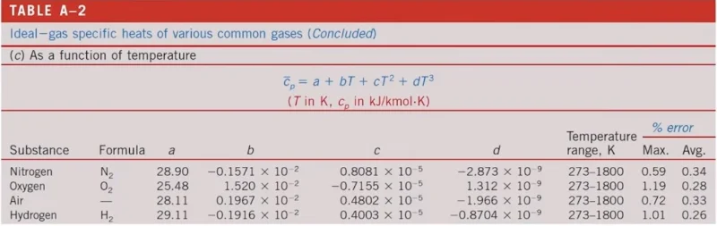

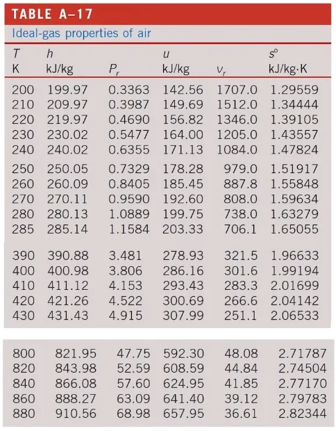

Let's say i want to find the change in enthalpy of air from 400K to 800K.
The most accurate way is to use the table A-17.(see picture)
"Find the table that has the enthalpy changes from a random reference temperature to find the enthalpy change as the difference between enthalpies."
Now the second option and less accurate than the 1st one, is using table A-2
"Find the polynomial coefficients and carry out the integral."
My question is why these two results aren't the same? The first is 420.97 kJ/kg and the second comes out as 422.66 kJ/kg .
In the second option, If I'm integrating then I'm taking into account that cp changes with temperature, so shouldn't this value be found both by the second method and the first?
Obviously that doesn't happen, so that leaves me wondering how are the values in table A-17 calculated? I falsely thought that they came from integration from the diagram cp-Temperature.

  • Excerpt of Table A-17, ideal-gas properties of air, listing temperature T in K, enthalpy h in kJ/kg, relative pressure Pr, internal energy u in kJ/kg, relative volume vr and entropy s° in kJ/kg·K for 200 K to 880 K.

  • Table A-2 (concluded) of ideal-gas specific heats: polynomial coefficients a, b, c, d for cp as a function of temperature for nitrogen, oxygen, air and hydrogen, with temperature range 273-1800 K and percent error.

The table in the first method used integration with respect to temperature also. It would seem to be a matter of the difference in the accuracy of the two fits of Cp. vs T.
