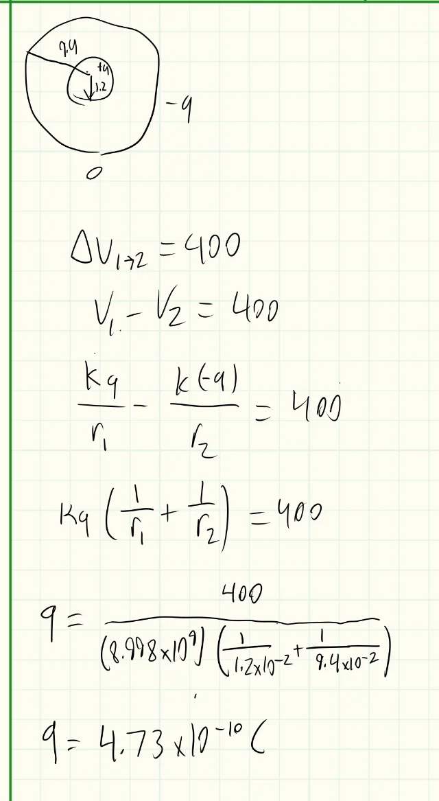

A metal sphere with radius 1.20 cm is supported on an insulating stand at the center of a hollow, metal, spherical shell with radius rb = 9.40 cm. Charge +q is put on the inner sphere and charge −q on the outer spherical shell. The magnitude of q is chosen to make the potential difference between the spheres 400 V, with the inner sphere at higher potential.
V(sphere) = kq/r
deltaV = V2-V1
I have attached a copy of my work. I know that the voltage for a sphere (assuming a reference distance of infinity) is
V = kq/r
I also know that I am trying to find the charge given potential difference or voltage between the inner sphere (charge +q) and the other shell(charge -q), so I attempt the following equation:
deltaV = 400
V1 - V2 = 400
kq/(r1) - k(-q)/(r2) = 400
Rearranging for q gives:
kq(1/r1 + 1/r2) = 400
q = 400/(k(1/r1+1/r2))
Finally, I plug in the numbers and get the following
q = 400/(8.998*10^9(1/(1.2*10^-2)+1/(9.4*10^-2))) = 4.37*10^-10 C
I know this answer is incorrect, but i'm not sure where I went wrong. I believe I likely flipped a negative, but I have redone my math several times and can't see where. Any help is greatly appreciated.
Did you realize you have a spherical capacitor? What you wrote down is the potential difference between two charged spheres separated in space by a distance much larger than either of their radii. That's not what you have here.

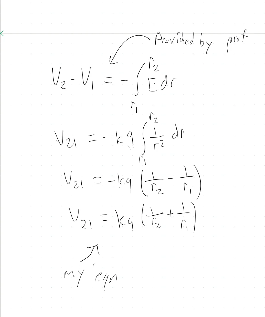

Thinking about it now, I realize that....although we havent learned capacitors yet. It seems to me that the capacitor formula you provided is the exact same as mine except a negative is flipped somewhere. It even says "The voltage between the spheres can be found by integrating the electric field along a radial line" on the website you linked.
If ##V_1-V_2=400## then ##V_2-V_1=-400##. That is likely where your sign got "flipped".

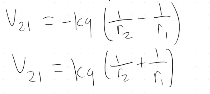

Does this look right to you? If you put the negative sign inside the parentheses, you must change the sign of both terms inside, not just one.
You are correct, that was a silly oversight. However, the more I think about it, the more I get confused. If the two spheres have different charges (q and -q), how can we use an integral that has only one q value. Additionally, I still don't see why my initial method did not work. The problem asks me the find the q which results in a difference of 400 volts between the surfaces of the two spheres. If I know the surface voltage of each sphere (assuming a reference distance of infinity) is
$$V_1 = kq_1/R_1$$
and
$$V_2 = kq_2/R_2$$
The shouldnt the potential difference (400V) just be
$$V_1 - V_2 = 400$$
I am not seeing where my logic falls apart and causes the flipped negative error.

I know i'm wrong because it is graded by a computer program and it told me I was wrong. Flipping the negative back gave the correct answer. I evidentially failed to properly copy the question, but it asks for q.
Think Gauss's Law.
Only the enclosed charge counts. If you draw a Gaussian concentric sphere of radius ##r##, (##r_a<r<r_b##), that encloses the inner sphere only, then the electric field in the in-between-region will be $$\mathbf E= \frac{kq}{r^2}\mathbf{\hat r}$$ regardless of whether the outer sphere has net positive, negative or zero charge. Thus, you can just do the integral $$V_2-V_1=-\int_{r_1}^{r_2} \mathbf E\cdot d\mathbf r.$$FAQ
