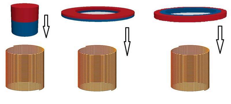

Can someone please explain/tell me what would be the resulting currents trough the coil in every of the three depicted scenarios in the attached picture, I'm confused here. Would the first and the second drawing produce the same result? Is there any current flow in the third drawing.

  • Three diagrams, each showing a coil of wire below a magnet with a downward arrow: a solid cylindrical magnet with red north and blue south halves, a ring magnet with red top and blue bottom, and a ring magnet with blue inner and red outer rim shown tilted.

The first and second will produce current in opposite direction(since change in magnetic flux is opposite in direction, due to, magnetic fields through the coil are in opposite direction), there is NO current in the third picture because of NO flux through coil(assuming the magnet is big enough to not have edge effects).
