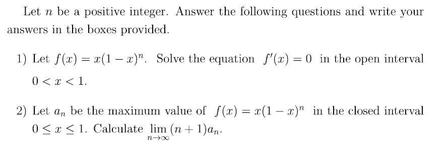

Hello, good afternoon guys. I need a little help from you: D
1)n a positive integer.
f(x)=x(1-x)^n
Solve the equation f'(x)=0 in 0<x<1
this question I asked and found x = 1 / (x + 1) ok
2)An be the maximum value of f(x)=x(1-x)^n in [0,1]
Calculate lim (n+1)an
n tending to infinity
the maximum value would not be making the derivative equal to zero? would it be x = 1? I did not understand

You did not do the first part correctly.
What is the derivative f'(x)?
Help, you could use the product rule, then set it equal to zero.

The maximum value might be attained at a critical point or at the endpoints of the closed interval.
Try plotting the function for a few values of ##n## to get an idea of what you should get.
