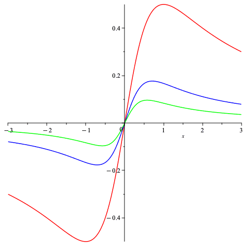

Here is my attempt at a more intuitive understanding of what is happening.
Here is a plot of ##f_1, f_2##, and ##f_3## in red, blue, and green, respectively.
We can see that the sequence of maxima are decreasing and approach zero. In addition, the integral test shows that this sequence is summable.
Now, what we are interested in is the limit ##\lim\limits_{n\to\infty} (f_1+\ldots f_n)## which is a function that we denote as ##f(x)=\sum\limits_{n=1}^\infty f_n(x)##.
That is, we are summing graphs such as the three above plus infinite others.
By using the M-test, we ascertained that this sum converges uniformly to ##f##.
As far as I can tell, we don't know what this ##f## is exactly though, right?
