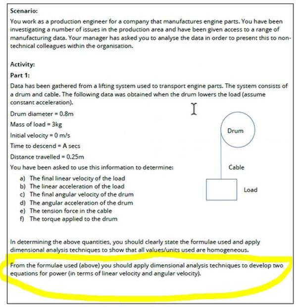

Hi guys,
Please see attached image - it's the part highlighted yellow that I'm stuck on.
Here is what I got for linear velocity and angular velocity. (requested by mod)
Thanks!
c) Angular to velocity
Dia=0.8m .. rad=0.4m
v (linear velocity) = r (radius of circle) * omega (angular velocity)
lets rearrange
linear velo (2.214 m/s = 0.4m* angular)
2.214 / 0.4
=5.535 rad/sec
d) Angular acceleration of the drum
initial angular velo = 0
final angular veloc=5.535
time=0.225756
formula=
angular acceleration = initial angular velo. (0) - final angular acc. (5.535) / t (0.225756)
angular acceleration=24.52 rad/s^2
PF rules require you to provide your own efforts. What are your thoughts on the part of the problem you are asking about?
Sorry I didn't realise that.
I pretty much don't understand the question and where to go with it
In addition to what @Orodruin has said, can I add this?
Before you get onto the 'hard' part of the question, you will need to deal with the ‘easy’ parts, a) – f), correctly.
Ask yourself: “If A (the time taken) is very large, would I expect different answers compared to A being very small?”.
E.g. imagine A = 3600s and then imagine again with A = 1s).
