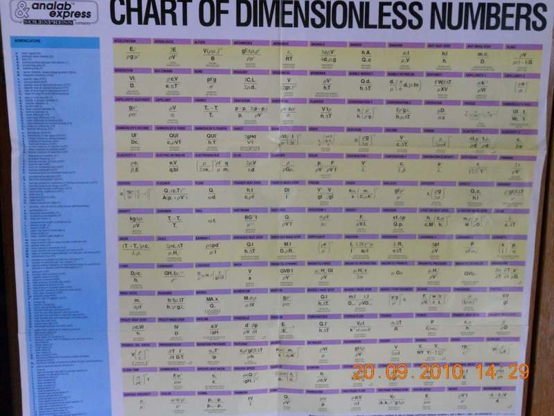

A while back I posted this list here in a discussion about the difference between constants and dimensionless quantities.
Perhaps some will be here.
https://www.physicsforums.com/attachment.php?attachmentid=28382&d=1284989819
