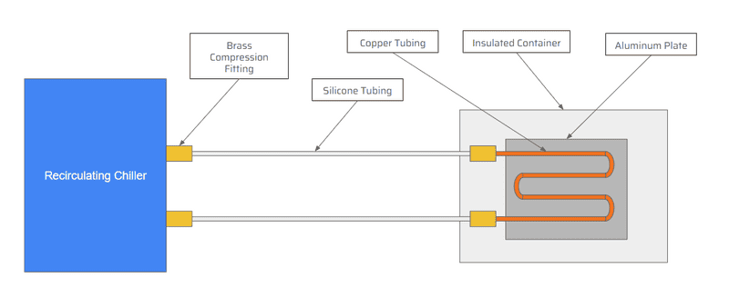

Hi All,

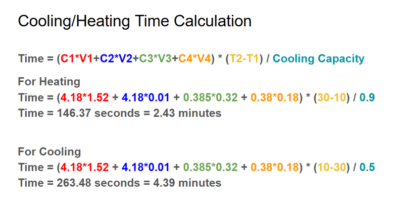

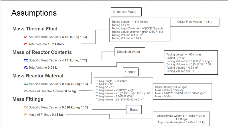

So I am trying to use a recirculating chiller to cool/heat an insulated container. This chiller sends deionized water through silicone tubing that enters the insulated container it then is passed through copper tubing in the container before it goes back through silicone tubing to go back to the chiller. The copper tubing fits into a slot on an aluminum plate that I am effectively trying to cool. The copper tubing is also clamped to this plate. The chiller has a temperature display on it that tells me the apparent temperature of the water. It tells me that effectively the temperature can go from 30 °C to 10 °C in 5 minutes. I have attached a temperature sensor to the aluminum plate to find that it takes around 40 minutes to reach 12 °C. I am trying to calculate if this temperature change should be this slow but have found from my calculations that the temperature change should be much faster. Im hoping someone can offer me an explanation as to why my math doesn't match my actual results.

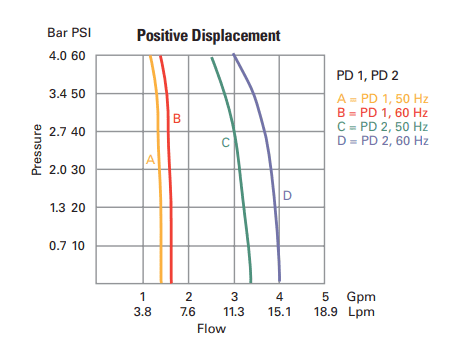

I am assuming the flow rate given this chart given by the chiller manufacturer and the pressure gage reading on the device

I am assuming the flow rate given this chart given by the chiller manufacturer and the pressure gage reading on the device View attachment 354695
What is your pressure differential across the chiller or the pump. Inlet pressure - outlet pressure? I ask because you say "pressure gauge reading" - singular.

That I'm not too sure The gauge on the device is measuring the outlet pressure of the fluid but I have no way of measuring the return pressure in my current set up.

Bigger pump or bigger pipes/less restriction. Though -- positive displacement pump? That's surprising for a chiller. It came with the chiller?
To me it seems like they are giving you optional pump curves. Anyhow, unless it is a differential pressure meter already plumbed across the pump you need a two measurements to determine the flow. The pressure on both sides of the pump. A one sided pressure in a closed loop is not helpful in regards to flow specification.

It seems to me that the heat transfer at the insulated container-copper tubing-aluminum plate side of the system (warming up the water) is much weaker than the heat transfer at the chiller (cooling down the water).
I see several possibilities:
1) Coolant entering the box is not as cold as you think
2) Coolant flow is slower than assumed
3) Poor thermal coupling between coolant line and Aluminium plate
4) Poor thermal coupling between Aluminium plate and box contents
5) Thermal leak into box from ambient
Check that there is good thermal contact between the Copper tubing and the Aluminium plate. You may have to change to a Copper plate and solder or braze the tubing to the plate.
For instance what is the temperature of the tubing just before it enters the cold-box, and what is the temperature of the Aluminium plate (or the tubing at the exit from the box)?
You may get further information by checking the temperature at various places on the Aluminium plate.
If the Aluminium plate stays close to the coolant temperature, try adding a fan in the coldbox.

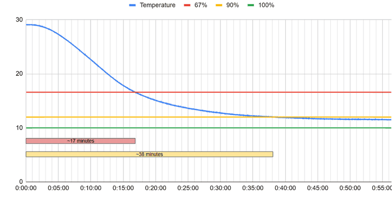

For what it is worth, your present, experimental, time constant is a bit over 13 minutes. Which is a close match to the 40 min. to reach ~ 90% of the target; it takes 3 time-constants to get to 93%.

Let's see your analysis/calculation for the plate temperature as a function of time. What surrounds the aluminum plate inside the insulated container? Is the plate sitting on the bottom of the container, or is it somehow supported within the container?
