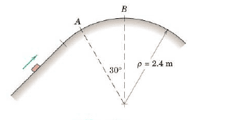

An = mv^2 / r
I get the 2D free body diagram, and how the vertical components are resolved, but how is Nc sin θ = mv^2 / r when they both are in the same direction?
Also another related problem is this diagram here:
The equation for the mass at B is,
mg = Fc + N
How is this so when both Mg and Fc are directed downwards (Fc being the centripetal force mv^2 / ρ). Shouldn't it be mg + Fc = N?
I guess I don't understand the direction of Fc due to the normal acceleration. in either of these problems.

In your second problem, a conceptual dwelling becomes a bit clearer.
Basically, there is no Fc. For an object to execute a circular motion, some force has to play that role.
In the first problem, the horizontal component of the normal force plays that role. Hence also the equality Nc sin θ = mv^2 / r.
In the second problem, the vertical component of the gravitational force plays that role. Not all of it, so there remains some normal force. (**)
A "much better" (ahem) way to write this would be mg - N = the force to cause a circular motion.
Since we generally like short notation, we often use Fc for "the force to cause a circular motion", so now that name is back again. But remember it is shorthand for "the force to cause a circular motion" (or the force that changes the direction of the velocity vector...)
(**) Well, if v is big enough, all of mg is needed to keep the object on the circular trajectory. Increasing v beyond that, the car will loose contact with the hill, since there are no other contribuant forces that might keep it on there.
[edit] Ah, I see it's not a car but an unspecified "mass". Story doesn't change.
mg = Fc + N
The way to understand it is to think of the net force at B: ∑F = mg - N. (mg is downward, N is upward) That net force is the Fc, so Fc = mg - N. Note that Fc acts downward.
Because it's so important, I throw in another reply:
In the top problem, there are only two forces working on the car: gravity and normal force. The (vector) sum of those is not zero due to the incline.
We have learned F = ma (but actually it is ##\vec F = m \vec a##). Where F is the net sum of all forces.
Furthermore, we have learned that for uniform circular motion an acceleration towards the center is needed with a magnitude mv2/r
So if we want the object (car, block, ..) to execute a uniform circular motion, we must ensure that the net sum of forces is pointing the right way (exactly towards the center) and has the magnitude mv2/r.
If you look upon Fc as something that is a resultant instead of one of the forces present, you almost can't go wrong.
I see. I thought of Fc as another independent force. It makes sense now. Thanks for all of the replies.
This is an important point. Fc is a resultant (or net) force, not a separate force of its own. Fc should never appear in a free body diagram.
