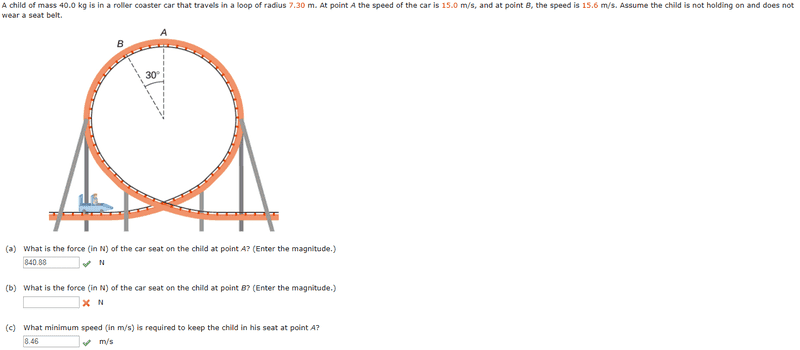

A child of mass 40.0 kg is in a roller coaster car that travels in a loop of radius 7.30 m. At point A the speed of the car is 15.0 m/s, and at point B, the speed is 15.6 m/s. Assume the child is not holding on and does not wear a seat belt.
What is the force (in N) of the car seat on the child at point B? (Enter the magnitude.)
Diagram of a roller coaster car on a vertical loop of radius 7.30 m, with point A at the top and point B on the left side of the loop, 30 degrees from the vertical, with the child seated in the car.
Fc = [(mv^2)/r]
Fc = ma
I solved (a) and (c).
I solved (a) by inserting the mass, speed, and radius into the equation [(mv^2)/r] and subtracting by (mass*gravity).
My equation for (b) was [(mv^2)/r * cos30] - mg = [(40*(15.6^2)/7.3*cos30) - (40*9.8) = 762.8 N. That was incorrect. What's improper about my equation? [/B]

In what direction is the centripetal force at point B ?
Also, is there any net force on the child at point B ?
120 degrees(90+30)?
I solved it by applying (cos 30) to mg instead of the centripetal force.
