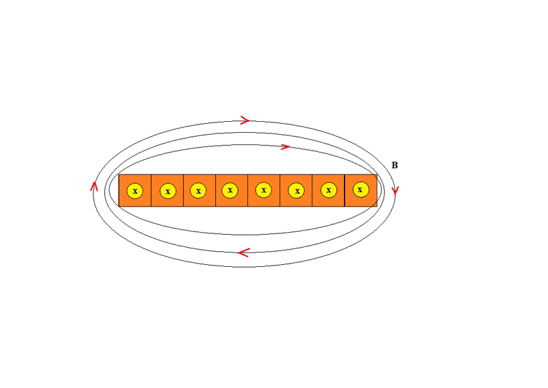

I have a set-up where there are multiple conductive wires separated by insulators placed parallel to one another and current ##I_w## is flowing within each conductor(all currents are parallel and equal),they create a magnetic field and I believe would add up like this diagram:
The current is flowing downwards, in the diagram above current is flowing into the page.
The way I diagrammed the magnetic field is it correct? Or approximately close to what it would be?

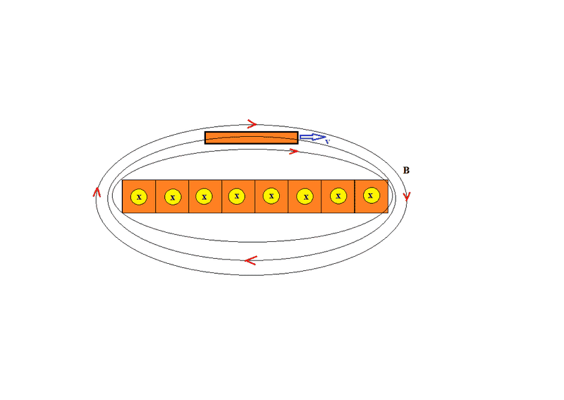

If there was a conductive loop placed in front of the wires, and moved parallel to the magnetic field like so:
Due to the motion of the loop being parallel to the magnetic field ##-\epsilon = 0 ## correct?

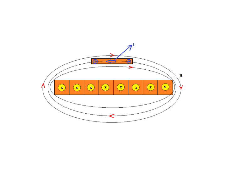

Finally, if we allowed current to flow in the conductive loop like so:
I'm not really sure what the Lorentz force acting on the wire would be, I'm assuming due to the current being opposite in direction the same magnetic field it would be zero...

First of all, there would be a few concentric lines of forces around the center of the individual wire showing that the wires would have a slight repulsion among themselves but it could be the case that these lines of forces could be of little or no importance if the loop is far away from the source of magnetic field.
Yes, the emf generated would be zero in the second case, since the magnetic field is not fluctuating near the loop, motion being parallel to the field (Assuming the magnitude of the field remains constant too).
The Lorentz force, I think, would be zero, since all the magnetic field generated by the loop is at right angles to the given magnetic field so no force would act on the loop. But it'd be an unstable equilibrium and the loop may experience a torque in anticlockwise direction w.r.t the diagram given, if disturbed.

I agree about the induced voltage would be zero due to the flux lines not being perpendicular to the velocity(although perpendicular to the length).
For the Lorentz force, since the current flows are opposite in the same flux lines they cancel out, there can't be a force.
