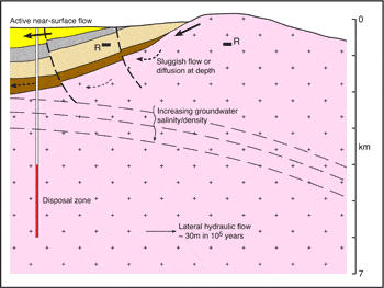

But what gives you the idea that burial in a subduction zone is simple, safe, and cheap, compared to storage in a near-surface, secure underground chamber? How deep do you want to go, and how much do you want to bury? I trust you don't think that a few hundred feet into the bedrock would be sufficient?
3-4 kilometers would do. Oil and gas exploration industry routinely drills much deeper than this.
Geological cross-section diagram showing a disposal zone borehole at depth, with groundwater salinity contours, sluggish flow at depth, and lateral hydraulic flow of about 30 m in 10^5 years; depth scale in km from 0 to 7.

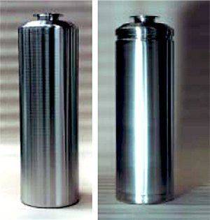

As to difficulty of burial, here's the end product of La Hague vitrification plant: a cylindrical canister of ~40 cm diameter:
Two stainless steel cylindrical canisters side by side against a plain background, each with a domed top fitting; the left one has vertical ribbing, the right one is smooth.
I don't see why lowering these down a borehole would be a problem.
That is a comforting assurance; where did you get the figure, and who ratified it? I assume that you have seen diagrams of what happens at the interface between the subducting plate and the overlying plate? Perhaps there are regions where such depths would suffice, but what sort of brinkmanship would be acceptable in playing chicken to see whether the canisters get truly subducted, or scraped off and exposed near the surface?
However, the point is trivial in comparison with the question of what it costs to drill so deep into hard rock. Is that your idea of a solution to the disposal problem, to rival the cost of near-surface storage? Even for a few centuries?
Suppose our store had a few thousand square metres of storage space; how much drilling (3-4 km deep forsooth!) would it take to dispose of the potential capacity of a store on such a scale?
"Out of sight is out of mind" is a tempting principle, but if it turned out that something had gone horribly wrong, such as say, the process of subduction not behaving as expected, where would you rather have the waste? Up here, or no longer quite so "down there"?
As to difficulty of burial, here's the end product of La Hague vitrification plant: a cylindrical canister of ~40 cm diameter: ... I don't see why lowering these down a borehole would be a problem.
I find that statement confusing. I thought that I had explained that the main problem is the cost of drilling, plus loss of control thereafter; a drilling engineer would no doubt be able to explain a few in addition. However, I DO hope that you are not under any illusion that it is just a matter of drilling and dropping! Just the delivery to the bottom of the hole, plus sealing them in place would be a fairly fraught procedure, compared to storage as I have described it.
What exactly had YOU thought?

For example, I noticed in passing that the capsules that you displayed as being easy to drop down the hole had been clad in metal by some wild optimist.
Was HE an idiot, do you suggest? Or did he just know metallurgy well enough to make realistic assumptions?

There are hardly any place on Earth where there is no underground water. Watch the videos. You seem to be typing so fast you did not bother watching them.
At and after 9:00 in this video steel borehole casing is seen to be rusted through.
