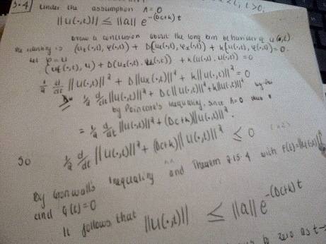

i was given the question below, and have submitted my working but i cannot move forward from where i stopped on the photo
Consider the diffusion equation (with source)
u_t (x; t) - Du_xx (x; t) + ku(x; t) = 0; 0 < x < ℓ; t > 0; under conditions of zero-flux at the boundary points x = 0, x = ℓ and the initial
condition
u(x; 0) = a(x); a(x) given:
The following problem is concerned with applications of the energy identity
(u_t (; t); φ(; t)) + D(ux (; t); φx (; t)) + k(u(; t); φ(; t)) = 0:
The average value of a function f over the interval [0; ℓ] is de ned as
Av(f) =(1 divide ℓ)∫ f(x)dx By letting φ = c
show that under the assumption A = 0
∥u(; t)∥(less than or equal)  ∥a∥ exp{-(Dc + k)t}View attachment 2181:
Draw a conclusion about the long term behaviour of u(; t).
  • Handwritten derivation on lined paper: under the assumption A = 0, the norm bound ||u(.,t)|| <= ||a|| e^(-(Dc+k)t) is stated, with energy identity steps, Poincare inequality and Gronwall's inequality applied.
I would suggest that if you are going to attach images of your work rather than typeset it with $\LaTeX$, using more lighting and higher resolution pics. It would be a real struggle (for me at least) to try to read your images.
