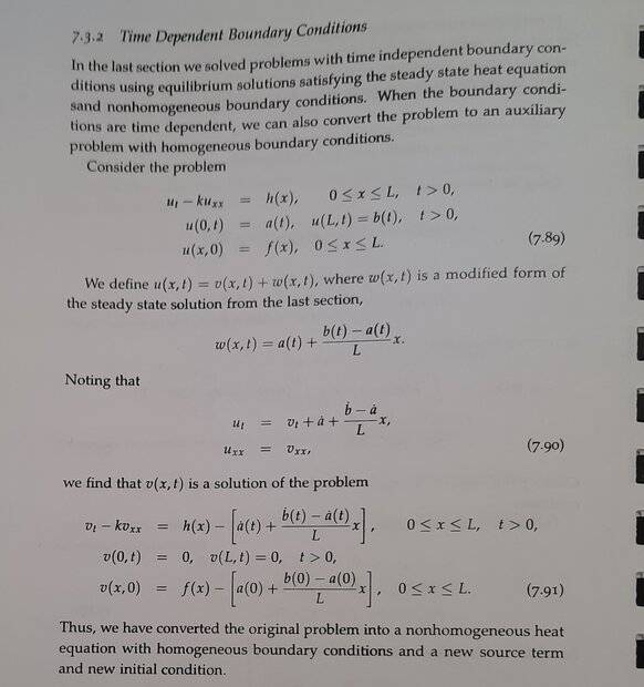

By which method could i analytically solve Diffusion Equation with this boundary conditions:
U=U(x,t)
Ut=DUxx; 0<=x<=L, t>0
U(x,0)=0 0<x<=L
U(0,t)=a(t); t>0 *a(t) is known function*
(dU/dx)=0 for x=L
I have looked into many ways but not one is usable for diffusion equation with this boundary conditions.
Standard method of separation by variables does not match up nicely with boundary conditions. I have seen methods for solving inhomogeneous heat equation using green functions, but that again failed, because it required knowledge of U(L,t) which was not given by any condition

November 2020 does have diffusion equation problem, but i do not know how to use any of information there to solve my problem. Soluton on picturem from the book is the case that mostly resembles my problem, but again i need boundary condition U(L,t)=b(t), instead i have flux that equals zero at that point U'(L,t)=0, so i can't use that metod

The idea behind solving the source-on-the-half-line problem is to transform the PDE for U with nonhomogeneous boundary conditions into another PDE for V with homogeneous boundary conditions, as is done in the attachment that you've posted.
