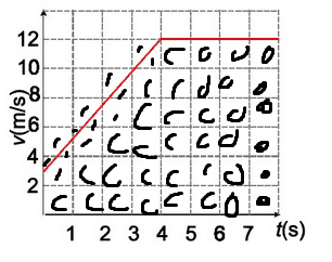

gladidi said:
The last point is to calculate the distance traveled by objects.
it is said that should calculate the surface area
Yes, in a velocity-time graph the distance traveled is given by the 'area' under the graph line. But the area of each square means the product of the coordinate intervals.
Here, the vertical grid lines are at 1 second intervals and the horizontal grid lines at intervals of 2m/s, so each little square represents 1 second x 2m/s = 2m.
Is this right way to solve this? example 35*2+8/2*2?
  • Velocity-time graph with v (m/s) on the vertical axis from 0 to 12 and t (s) on the horizontal axis from 0 to 7. A red line rises from about 3 m/s at t=0 to 12 m/s at t=4, then stays flat at 12 m/s. The background is filled with handwritten scribbles.
That is the right answer. I cannot tell whether you are expected to do it by counting squares are algebraically. I would use standard formulae for areas of rectangles and triangles.
35*2+8/2*2? is 78m but it's not right..
You want the distance for the whole 8 seconds, right?
In the first 4 seconds the average speed is (3+12)/2=7.5m/s. Over four seconds that covers 30m.
For the remaining 4 seconds the speed is 12m/s, giving a distance of 48m.
30m+48m=78m.
