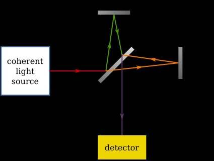

Now, with regards to the Michelson-Morley experiment, if we did not use length contraction which is not part of Galilean mechanics, there WOULD be a difference in roundtrip time for the perpendicular and parallel light beams, right? See the figure below:
Because of the mathematics of inverses, the total travel time back and forth parallel to the relative motion of an "ether" would be greater than the back and forth travel time for light perpendicular to the "ether." That would be true in a Galilean or Newtonian Universe, right?
If there was an ether in which light traveled, then there would be an expected time difference. One way to explain the null result is with Fitzgerald's length contraction proposal.

So, again, as far as Michelson-Morley III is concerned there is no closing velocity and c is the only velocity (in a vacuum) that light either approaches or eminates. There is no need to adjust with the 1/[tex]\gamma[/tex] correction factor to make-up for lost time by shortening the distance because light going parallel to the Earth's tangental orbit and light going perpendicular to it are going at the same speed relative to the MM apparatus.
That apparatus bangs the light back and forth for 22 miles (35 km), doesn't it?
In the frame of the lab, there is no "closing speed" but in any frame at rest wrt the lab, you need both closing speed and length contraction in order to explain the null result.
No, it doesn't. This would be a huge distance. The longest light trip in MMX is about 32m, three orders of magnitude smaller than what you are thinking. See here

It seems that this explains the length contraction part of relativity. You need
[tex]\gamma[/tex] = SQRT[1 - u2/c2] to make the elapsed times of the roundtrips parallel and perpendicular to the motion of the Earth to come out the same otherwise the roundtrip times over the 32 meters wouldn't come out the same.
Actually, if I remember the derivation of this correctly, the equations never establish any relationship between the relative elapsed times of the round trips other than that they are equal. By equation (1.2) in starthaus's blog on the MMX,
t = [tex]\gamma[/tex]l1/c which means that when v = 0, [tex]\gamma[/tex] = 1, so t0 likewise "expands" to t1 = t0[tex]\gamma[/tex] as v > 0. Maybe I have the t's backwards but you get the idea.

starthaus - the 22 mile distance I was referring to was the 22 miles between Mt Wilson and Lookout Mountain used in the 1920s by Michelson to determine the speed of light (actually through air.) He did it with a rotating octagon mirror sending reflected light to a mirror which reflected it back.
I am pretty familiar with the experiment. It has nothing to do with time dilation and/or with MMX.
  • #32
Absolutely true... I was just correcting myself about the incorrect distances I stated earlier for the MMX apparatus mirrors, that's all.

Is my later comment post 30 about the necessity of length contraction and concomitant time dilation also true (see above?)

The MM experiment can be completely explained by length contraction alone. Once you know the length contraction factor you soon work out the time dilation factor by calculating light travel times parallel to rod with relative motion. If you workout the light travel time for the zig zag taken by the light moving along the transverse arm you can obtain the time dilation gamma factor without involving length contraction. This is essentially Einstein's light clock thought experiment. In fact Einstein never mentions the MM experiment in his 1905 paper.
Your welcome. My posts are as much for my benefit as they are for you or anyone else. I had to think real hard about the signs in the velocity addition equations (and I am still not 100% sure I have it right :tongue: ) Why is that getting positive and negative signs right seems to be one the hardest things in relativity??
