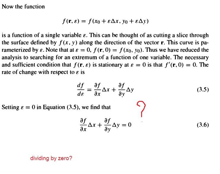

Hi,
I'm studying calculus of variations, this is a bit of a recap of regular calculus.
You got a function, but you plug a vector that is parameterized so your function becomes parameterized, then you take the derivative in 3.5, and then they say: put the parameter to zero in 3.6, but then you divide by zero, I don't get it.
Cheers
Where are you dividing by \varepsilon then?
You are just using the condition that
$$f'(\vec r, 0) = \left. \frac{df}{d\epsilon} \right|_{\epsilon = 0}$$
i.e. ##\varepsilon = 0## is a stationary point to set the left hand side to zero.
Likes 1 person
It doesn't set dε to 0, it sets ##\frac{df}{dε}## to 0. The rate of change of f is 0 at ε = 0 because f is stationary at that point.
Likes 1 person
Are you under the impression that \frac{df}{de} involves dividing by e? It does not.
\frac{df}{de}= \lim_{h\to 0}\frac{f(e+h)- f(e)}{h}
Likes 1 person
My god.What a mistake.
It's been a while since I've encountered calculus.
I better review the basics thoroughly than tackling some more advanced stuff.
