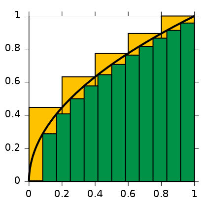

What do you mean by an "upper area"?
Sorry, I just found this pic online. The upper area is the yellow one, the lower is the green one (for a generic function).
Suppose you choose an ε. Can you choose an interval containing x=1 such that the upper rectangle has an area less than ε?
